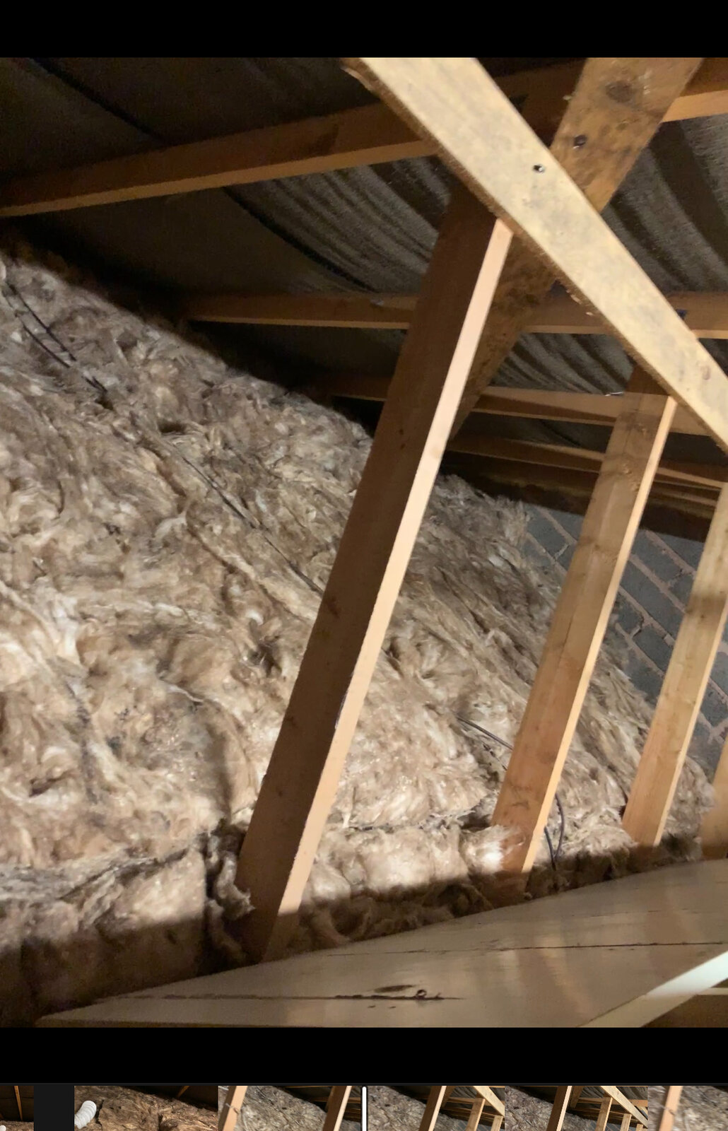

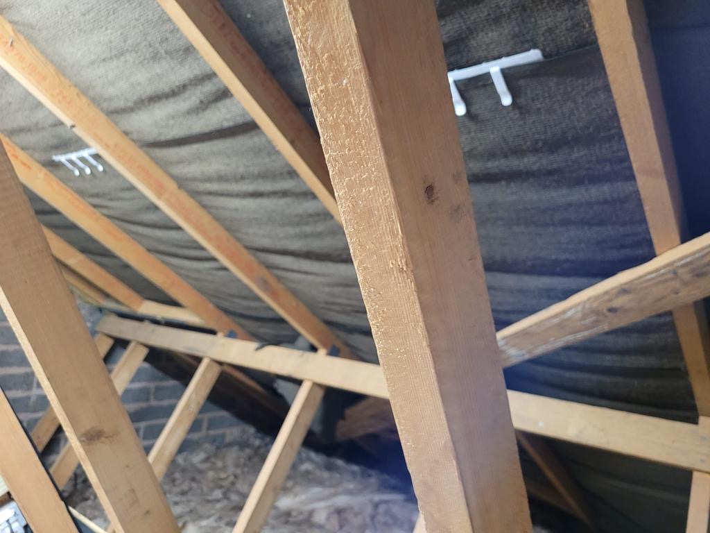

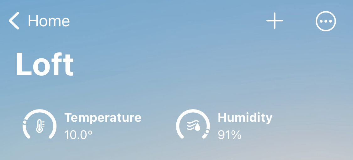

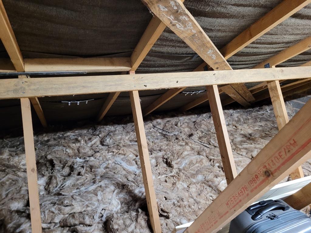

Appreciate this is from many-moons ago @mikey90 , but did your vents work? I have recently 'serviced' my loft, as it needed deeper insulation to help keep the house warm / reduce heat rising into it ... and I have added lap vents to the felt, but the sensor still says it's around 80% humidity!
Did your similar approach help reduce the humidity like you hoped?
And would anyone have any suggestions as to why mine is still at a high humidity?
Thanks for any replies.

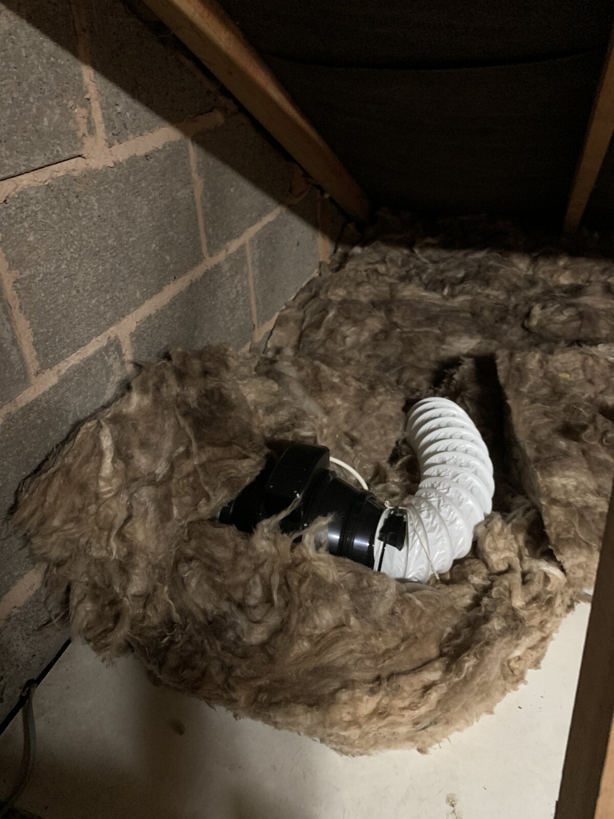

Why is there an extractor and duct seemingly going nowhere?
That could be my loft. Same construction, same felt under the tiles, same grey block gable wall, same insulation. 11°C, 89% RH.
Do you actually have a problem with damp/mould in there?
I assume that extractor vents to the outside wall?
If you have a problem with moisture condensing on the inside of the extractor tubing and running down into the bathroom, lag it.
I'm glad you asked that.
Thanks for that link - I’ll give it a read. It’s connected to the bathroom, then out to the side of the house. I had a stronger fan fitted, because of issues in the bathroom

There are a few oddities up there … maybe it is yours? That side, no I currently don’t - but am looking to prevent that, as I have read people’s lofts have seen damp due to humidity
Mine is very similar to yours @mad.phase - Often hits 90% RH with temp around 11 C.
Yet even with those readings I can sometimes find the loft dry without any condensation. Other days there's loads of condensation (mostly around plastic roof valleys). It's very random. The condensation turned to light mould on some of the woodwork too.
I have loads of lap vents and plenty of ventilation, and insulation pulled back from soffits. Done everything I can think of. The only thing I have left is to install a vapour barrier and reinsulate the whole ceiling.
