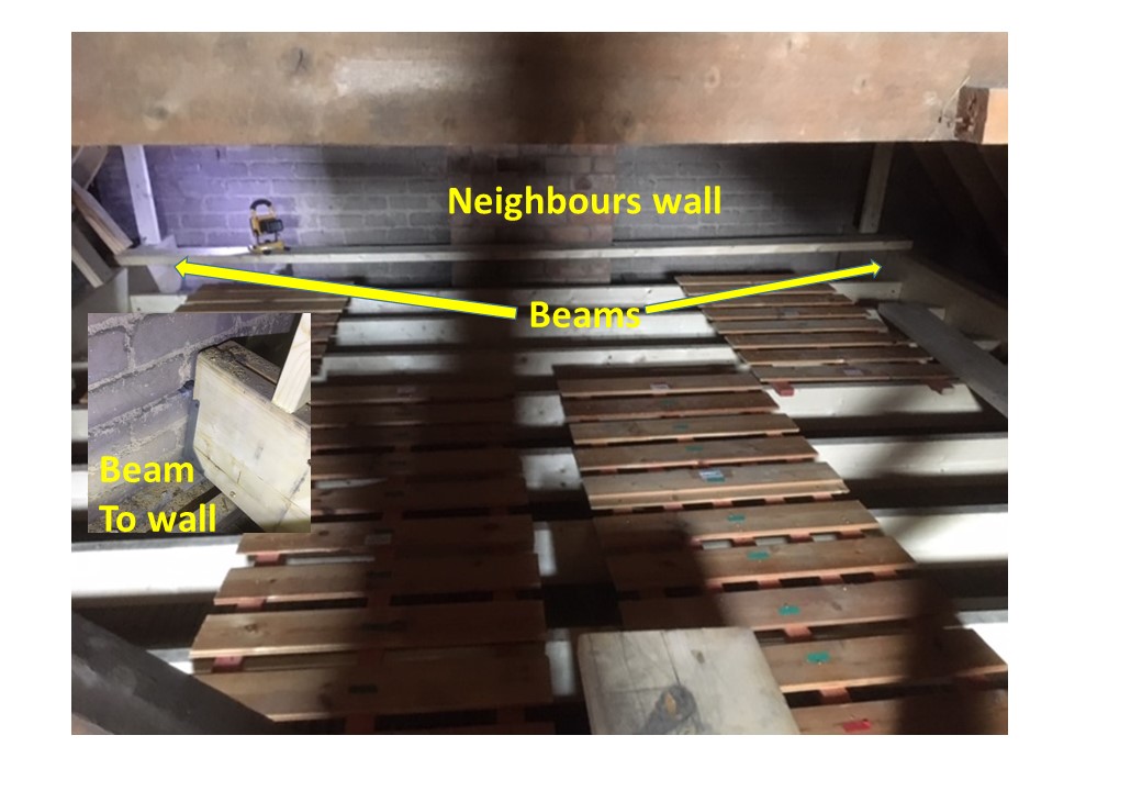

Loft Conversion: do beams have to be closed up to run joists across them?

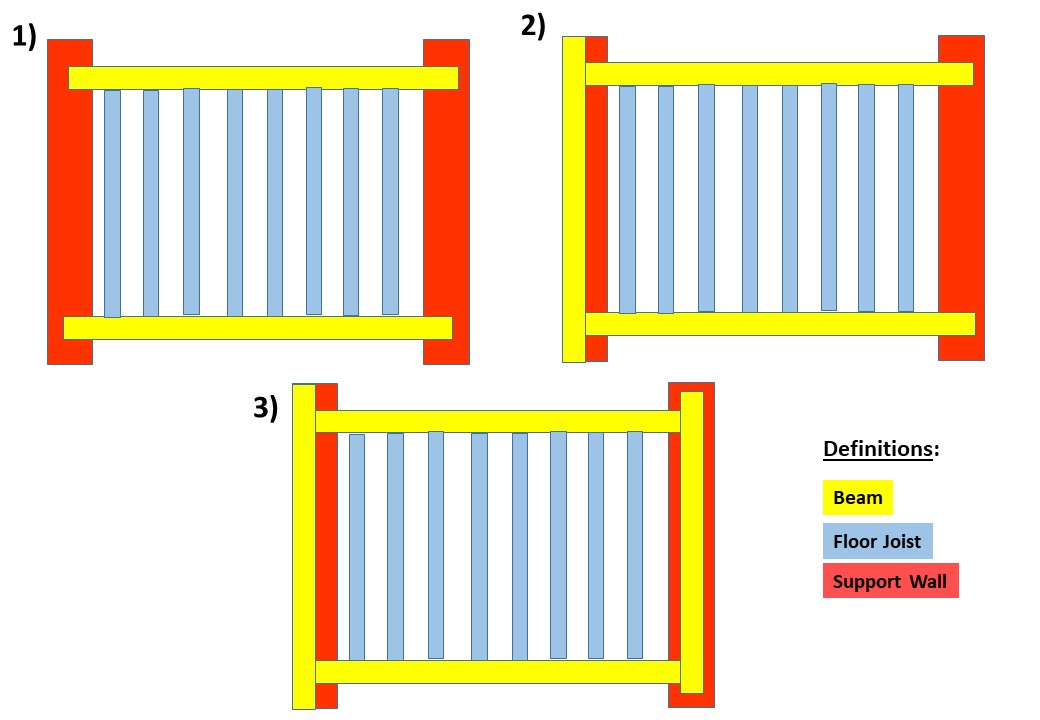

In other words, which of the 3 options on the drawing are correct? Or all of them are fine? Please comment.

1. is fine, 2 and 3 redundant (why use a beam to support joists when you already have a wall?).
The main beams don't have to be 'closed up'.
Is the question about whether the ends of the beams need to be restrained or built in in some way?
You are right. The reason I put options 2 is because that's what our builder suggested, so I thought you need to have beam ends restrained or built into something solid, hence option 2. Since on the left - it's the end of the house (free space) - I thought option 2 is a minimum to have.
Option 3 - would be realised if the horizontal beams in option 2 on my drawings are connected to other horizontal beams from the 2nd half of the loft (not shown), which are also built in into the neighbours wall (semi-detached), hence the beams on 2nd half are like option 2 but with the image flipped horizontally.

The project is frozen at the moment, builder got ill - no one to ask for now. But option 2 is what he was discussing with joiners couple weeks ago. Hence while builder is away - I wanted to double check if that is really necessary to have beams closed up - to be in better position to discuss with him when he's back.

Thanks Johnny. If the option 1 is OK and the beam ends can be free-hanging - why attach them to neighbours wall on the other half of the loft?
That surely is not your neighbour's wall, that's a party wall that belongs to both properties.
Usually, as you will need a party wall agreement in any case, you would dig into the wall and encase the beams into it (with spreader plates).
Using hangers personally wouldn't be my first choice because the fixings would be pretty close and cracks might make the whole floor fail.
