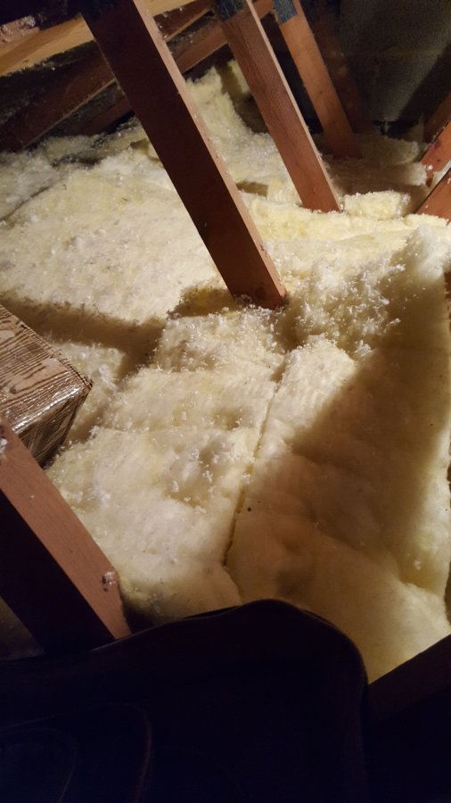

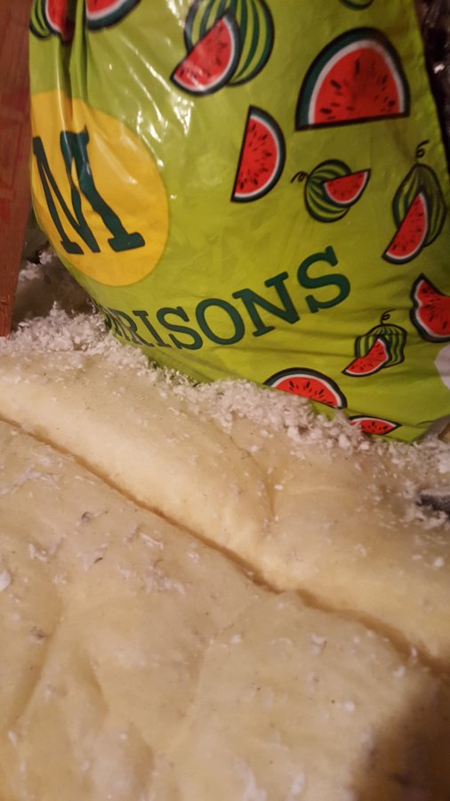

Hi guys would anyone know what the white stuff is in my loft? It's on top of the yellow insulation
Cavity wall insulation that's blown out the top of the cavity in places and settled on the yellow insulation
