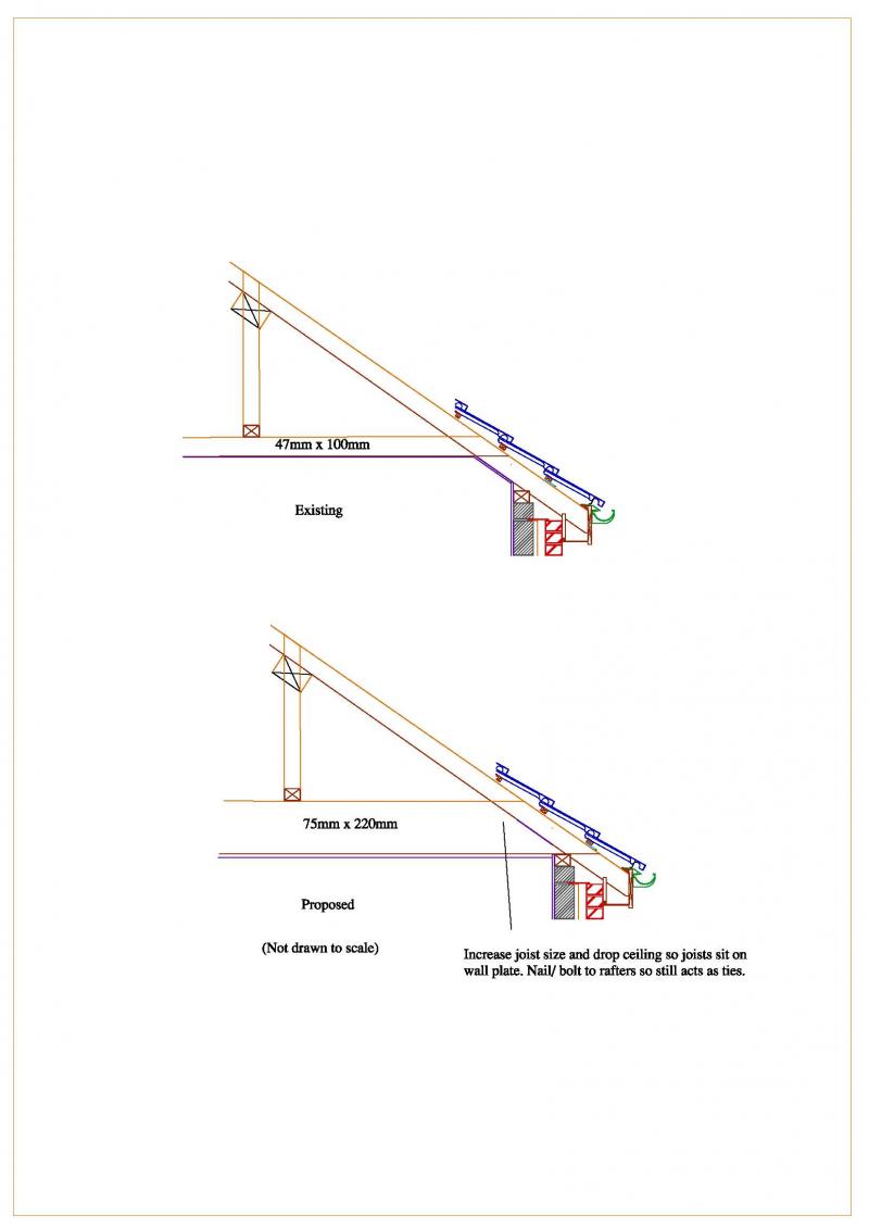

Hello all, I'm new to the forum and this is my first post so apologies if this has come up before.
I am not a builder by trade but last year completed a large extension on my house without any trade assistance (apart from elec, I did the CAD drawings and BC spec myself also). I added three rooms and am very happy with the result, so I would consider myself a competent diy'er with a big emphasis on preparation and planning.
Now that is complete I am planning a loft conversion, which again I intend to do myself (obviously a BC notice will be submitted). I want to avoid steels if I can.
To get the headroom I am going to drop the first floor ceilings
The existing 2" x 4" joists that hold the ceiling do not sit on wall plates and are ties approximately 1/8th of the way up the rafter (probably so the could use 4.8m length timbers). As the clear span is large (5.2m) I am intending to use Posi- Joists etc for good strength to weight.
I want to sit the new Posi joists onto the wall plate which will mean dropping the ceiling 200mm, by the time the Posi 's are in I should gain 100-150mm headroom, which would be acceptable for a teenagers bedroom.
So far straight forward, question is once posi's are in, is there a fixing I can use to attach them to the foot of the rafter, so I can remove the existing 2" X4" ties? Or can I nail the Posi as with timber joist?

I'm not sure I explained it properly, rafter spacing is 350-380mm centres with existing ceiling joists/ ties attached approx 200mm above wall plate all on same side of rafter (every rafter full width of roof). I would like to attach the Posi joists to the opposite side of the rafter (every rafter) bearing on the wall plate and fixed to rafter, then remove original beams. So theoretically all I am doing is replacing the existing 2 x 4 with Posi beams. The beam would take the load for the floor and if attached to rafter foot would also prevent rafter spread. I am just unsure how the Posi can be fastened to the rafter, nails or special metalware bracket?
Simple solution is I could use 9 x 3, sit it on wall plate, nail to rafter the remove 2 x 4 (other ride of rafter), but if I could do the same with Posi then much easier to handle and manoeuver, the span is 5.2m. :confused:

You will probably find that the posi-joists will be about 450mm deep.. which may cause detail issues when you hit the wall plate.. steels are uses to break down the spans so you get shallower timbers..
Hopefully the image below will explain better what I would like to do. I knocked it up quickly so its not to scale but I have put on the timber dimensions. The new joist member should be big enough for the span, according to span tables.
Obviously this is a solid timber joist, my original query was if I used a Posi instead is there a way of fastening it to the rafters in addition to sitting on a wall plate? (To prevent rafter spread).
