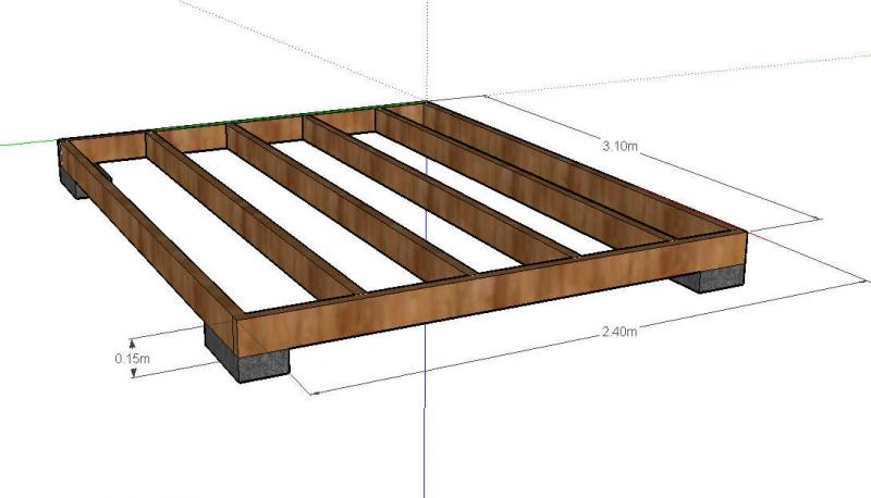

After researching on here, I seem to be more confused than ever. I have a 11’ x 9’ log cabin arriving soon and need a solid base to stick it on. My plan is as follows.
6” x 2” timber (or will 4 x 2” we adequate?), High density concrete blocks (would more blocks be better?), all sitting on 6” of type1/MOT1.
Is this sane?
Cheers in advance.
What have the makers of the cabin suggested?
I'd say "knock it together with 3x2" but then it would likely collapse under the weight of the log cabin :D
THe manufacturers recommendation should be sought.
