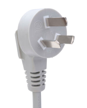

Each is fitted with standard UK 3 pin plug. They are earthed to their metal casing.
Found this voltage regulator on ebay:
https://www.ebay.co.uk/itm/AC-220V-...474438&hash=item261f0c372e:g:kC8AAOSwxGBc~12R
I would have to replace the plug with UK one.

What sort of 3 pin plug is that? -not come across that before (n)
And you would need to change the socket on the controller to accept your standard 13A motor plug.
