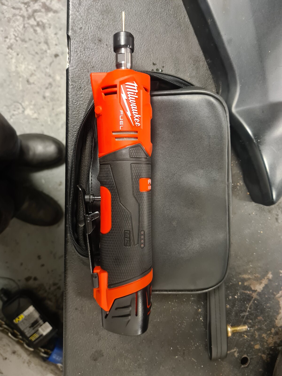

My Die Grinder turned up, ordered a 3.2mm to 6mm collet adapter so I can use Dremel bits in it as well.
What a great tool!, I'd describe it as a Dremel on steroids to be fair.
Some jobs the Snap-on air Die Grinder will still come out due to it's grunt but I'd say for 80% the Milwaulkee will do the job (nice not having an air line hanging out of the back).
