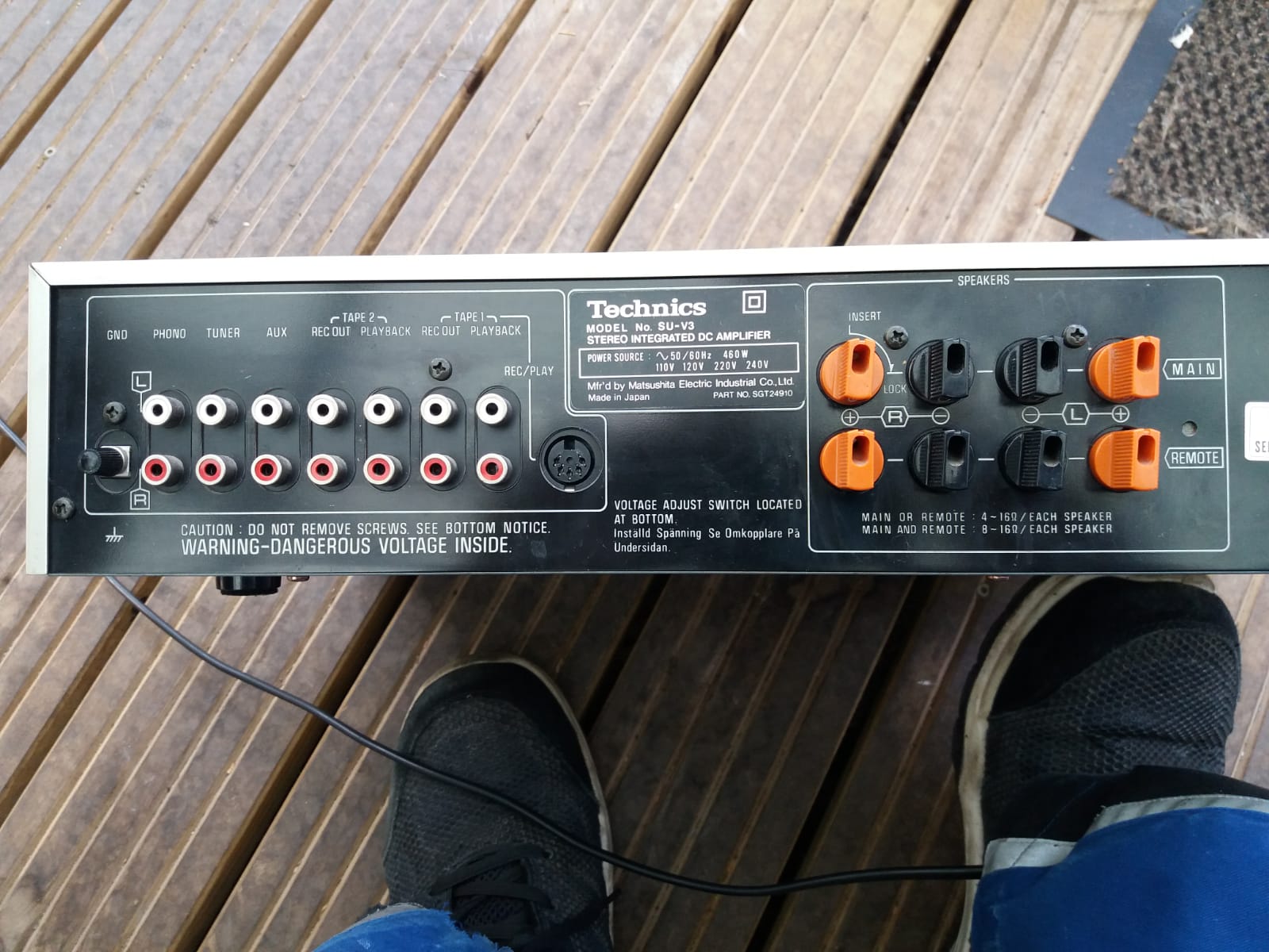

Ok so I've located my old amp! if this is suitable can I just buy a lead that will go from my phone to say the auxilary on the amp?
Yep. That'll do just fine.
Presumably, your phone has a standard headphone socket? If so, then a lead similar to this will work: 3.5mm to stereo RCA These sorts of cables come in various lengths, so just choose something appropriate for your needs.
The speakers could end up sucking a fair bit of current if you're enthusiastic with the volume knob. Buy some speaker cable that's all copper so it can take the power. Avoid anything listed as CCA (copper clad aluminium). No need to go mad, just a decent quality all-copper. I'd recommend something at 1.5mm2 thickness unless you plan to run the speaker cables more than 20m to each speaker. Something like this one will do just fine. There's a pinstripe down one of the two conductors so it helps keep a track of the terminal colours you're connecting to.
Hook up to the MAIN speaker terminals. Connect Black to Black, and Red to Red, from the amp to the speakers.
Bear in mind that the speaker and amp may not have run for a while, so remove the speaker grille covers and have a look at the drivers themselves. Check the suspension ring that attaches each of the speaker cones to the outer metal ring of the speaker. You're looking for cracks or tears in the foam or rubber.
With the amp, make sure the volume is turned all the way down before switching on.
For this first outing, use it at low volumes to begin with. You're listening for any distortion in one or both of the channels. Over the course of an hour as the amp warms up, gradually increase the volume until the dial's pointer is at 10 or 11 o'clock (3 to 4 on the dial). What you're doing is gently breaking the amp in again after months or years of no use. It's the same for the speakers. In old amps, the first thing to let go will be the big output capacitors that act as power reserves. What can happen is that they dry out due to heat and age. It doesn't happen all the time. I've had amps at 30 to 40 years old that run just fine, but others at under 10 years old that had poor ventilation, so they slowly cooked to death. Banging the amp on at half volume from cold could just tip the balance to a failure, so start gentle each time and let the amp and speakers wake gradually over a 10 minute period.
