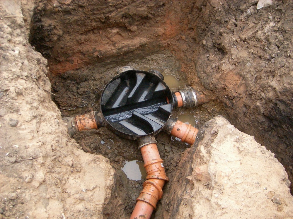

We have a manhole in the middle of our back lawn. It is about 10m from the house. In the summer when it is dry, you can see down the 15" dia pipe about 6 feet. At the bottom, there are gullies coming in a different angles, but we suspect that all but one of these are closed/blocked. In the winter, the manhole fills with water, but is usually 2-3' below ground level. In really bad rain (late 2013), that corner of the garden flooded. The water in the hole is slightly brown coloured.
As far as we can tell, nothing drains from the house into this hole. So, is it likely to be part of a soak away system? Does the hole fulfil any purpose? To me, it is just a useful hole into which I can drop a submersible pump when the garden floods in heavy rain.

The '15'' diameter pipe' is probably inspection chamber risers and the multiple gullies sounds like a chamber base.
Is this stuff all modern plastic? and does it look like this inside?
http://mybuilder-uploads.s3.amazonaws.com/2_thumb/420976_1c627c2a82.jpg

Ithe inspection chamber is black plastic. And the bottom looks just like your photo.

In that case it must be some part of a land drain or soakaway system.

I think that the soak-away system is the most likely, but I still do not know why it has an inspection chamber/manhole.
