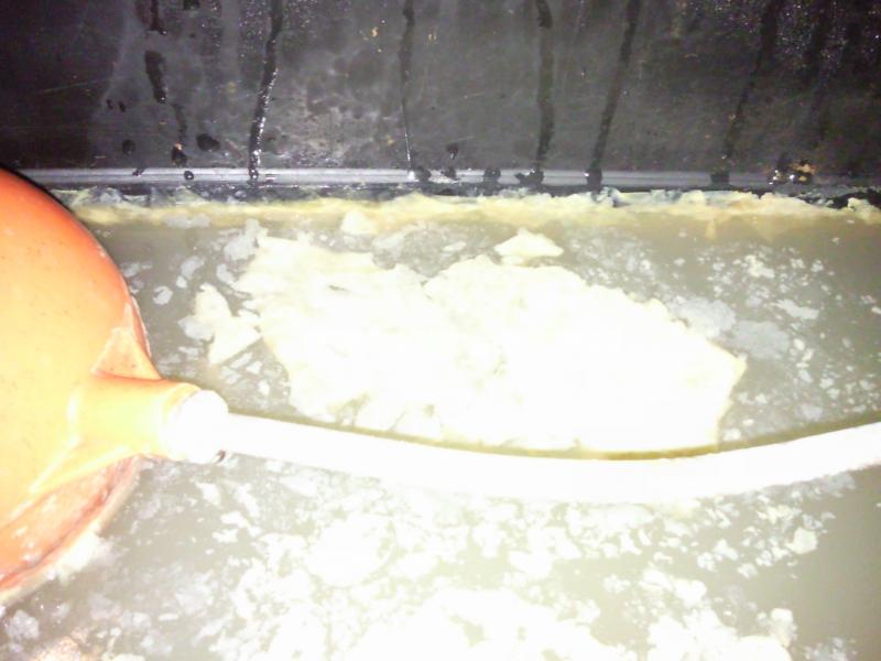

However when I removed the cover from the F/E tank this is what I was faced with:
Bearing in mind that I scrubbed this tank clean before I refilled last time (about 6 weeks ago!), any ideas on what on earth this manky white gunk is, and where it has come from?
Recommended course of action? Presumably I'm going to need to bail all that out and flush the system through again?
Could this be caused by the X200? It is the only thing that I've added differently to usual?
Could it be this gunk, (or rather whatever reaction is creating it), that is causing the air build up in the system?

your description is vague.
Is it white slime? Is it a crust of fungus?
what depth of water is above the exit pipe near the bottom? the float looks as if it is sticking out of the water.
Appologies, I've not actually touched it yet, but the jam-jar did when I was testing the vent.
It not a fungus like crust, nor would I class it as slime. Perhaps more of a 'scum'. Like if you left water in a basin that had had a bar of soap in it, or say a sink of washing up water that had washed greasy dishes.
Yeah, definitly a 'scum' would be the best description, if you want to know anymore than that then I'll go back up tomorrow and dunk my hand in the goop!
Not sure on the depth over the fill pipe, but it doesn't seem any deeper or shallower than usual. I'll have to measure it to actually give you a figure for it.
Is there a depth that is recommended?
a couple of inches will do. To my eye it looks very shallow.

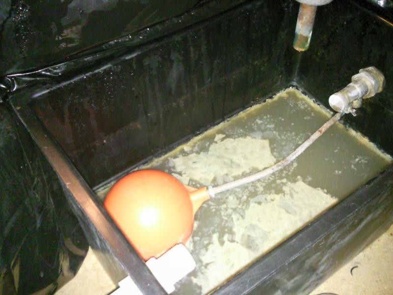

If you have bacterial slime or fungus crust, clean it out thoroughly, scrub, wipe over with bleach all surfaces including lid and float, buy a bottle of Fernox AF-10 Universal Biocide (it is expensive) and add half the bottle after refilling the F&E (so the F&E holds the max concentration, stir it in, splash it over the float and arm, sponge the lid with it. You may have to get a proper plumbers merchant to order it for you. Keep the other half bottle to add when you get a recurrence, or if you have to drain or refill the F&E and it gets diluted.
Once you have got an infected F&E, the infection will always be present. Do any other cleaning or inhibiting work before you add the biocide as it is so expensive. There might be some other equivalent product but I don't know one.. Fernox is a top brand.

If you look at the header tank, the position of the overflow is incorrect... It should be below ball valve discharge point i.e. the valve should not submerge when overflow takes place.

When bailing it out, it wasn't crusty, and it wasn't slimy. It was more of a 'flock' (you know when a solid clumps together in a liquid). Not sure if that makes any difference, but I thought I would let you know.
I had a closer look last night, and this is definitly wrong then :(
In order for the overflow to actually 'operate' the ball valve has to be completely submerged, the inlet is pretty much completely submerged, and even the end of the vent pipe is under the surface of the water.
Also through my experimenting (removing the ball float from the valve) it seems that the inlet can fill the tank faster than the overflow can empty it, which I'm going to presume is not a good situation to be in if the ball valve should fail!
So I should lower the overflow, (I'm presuming I can get a blanking plug for the old 'hole' that will be left in the tank?). Should the overflow also be a larger bore pipe than the inlet? To be honest the overflow from both this and the main water storage tank both scream of 'bodge', or at least bad workmanship :(
