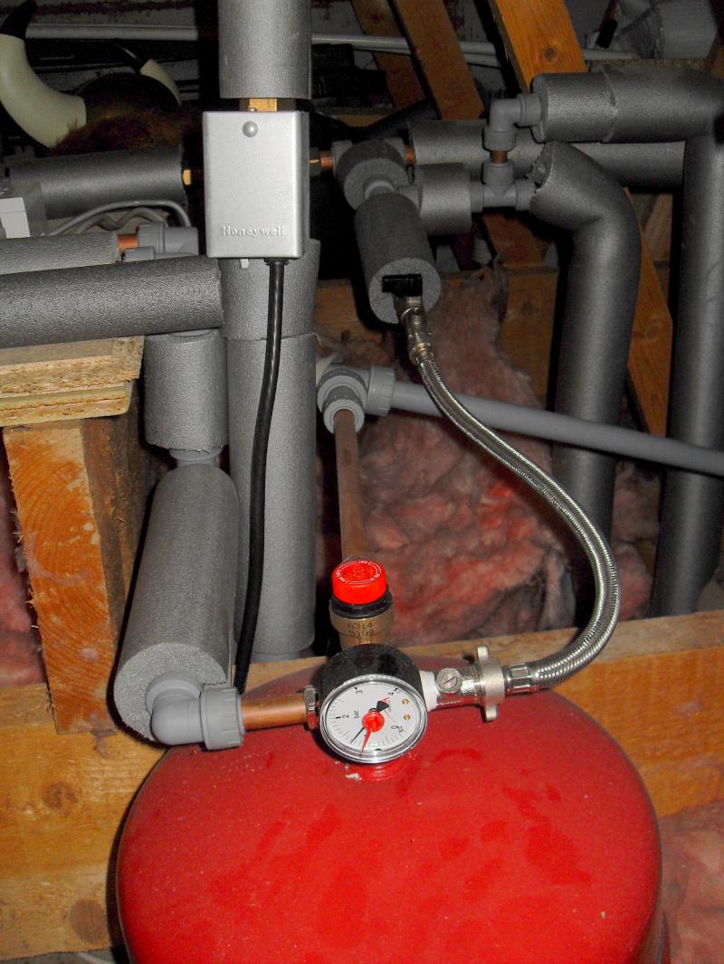

    We have a Megaflow which has lost pressure. The overflow pipe outside isn't dripping, though.
    We have followed the instructions but the lowest hot water tap never stops running! Yes, the mains is well and truly shut off, and yes, the system is 'off'.
    You can see from the photo that this is what the pressure valve (?) looks like. I am wondering if our failure is something to do with that black tap on the flexible hose (to the right of the 'Honeywell' logo) which has been left in an off position. If, whilst they system is on, you turn that tap to 'on', you hear water flowing and the black needle on the dial rises til you shut off the tap... what is it doing??
    We recall we were once told that there was 'additional step' over and above what the printed sticker on the side of the cylinder tells us to do but damned if we can remember what but I suspect it has something to do with this mystery tap, in-line with the expansion chamber (the big red thing, I assume!).
    Any ideas? Be kind, I am a radiographer so can talk you through the physics of an MRI scanner but am less good at domestic plumbing!

    Nothing to do with the Megaflow. . Turn the black knob at the end of the flexible the.
    When the pressure gets to 1.5, turn it back.

    Suggest that you STOP STOP STOP right there, the big red thing is an expansion vessel for the water in your heating/boiler circuit only, NOT the hot-water that comes out of your taps.
    Can you post a picture of the cylinder itself and the pipework that emanates form it?, and we'll take it from there.

    OK, had another go at it (leaving that black tap alone!). I see the red line on the meter (see original photo) is set at '1' but the black line, the needle, is on 1.75 ish. Presume that's OK??
    Anyway, we did everything according to the instructions, I opened the TPR valve and got about 5 seconds of gurgling, the hot tap stopped running (!) so, so far, so good- but I can't say we've noticed anything other than a slight improvement in the water pressure....

    The red tank in your picture is the expansion vessel for your central heating/boiler circuit and not the primary side of your mega flow hot water tank.
    It should never read 0, pressurize it up to 1.5-2 bar when the system is hot by using the black tap on the end of the flexible tube.
    Regarding your issue of the hot water tap continuously running and the mains stop cock being shut off, it sounds like the washers have gone on both of them leaving them open and allowing water to flow.
    The mega flow is pressurized by a valve as shown by the following picture, that may have gone, the valve shown allows you to isolate the cold water supply to the tank and is normally set to 3 bar.
    [​IMG]
    The mega flow also has an expansion vessel, but it is internal to the tank and can't be serviced to my knowledge.
    Also, don't rule out any other issues due to airlocks.
