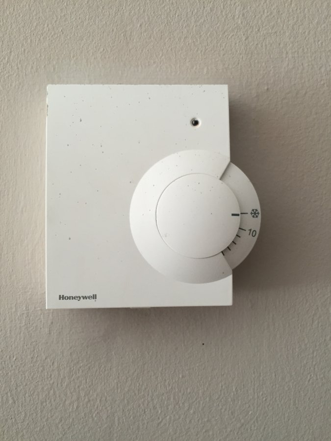

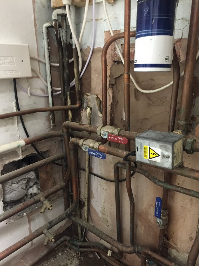

Photos of your existing controls might be interesting, including the room thermostat, because one way of doing it would be to add a programmable stat.

I think the valve in photo is wired to the thermostat and controls supply to radiators and cylinder dependent on the thermostat.
I guess a programmable thermostat would do the job then?
