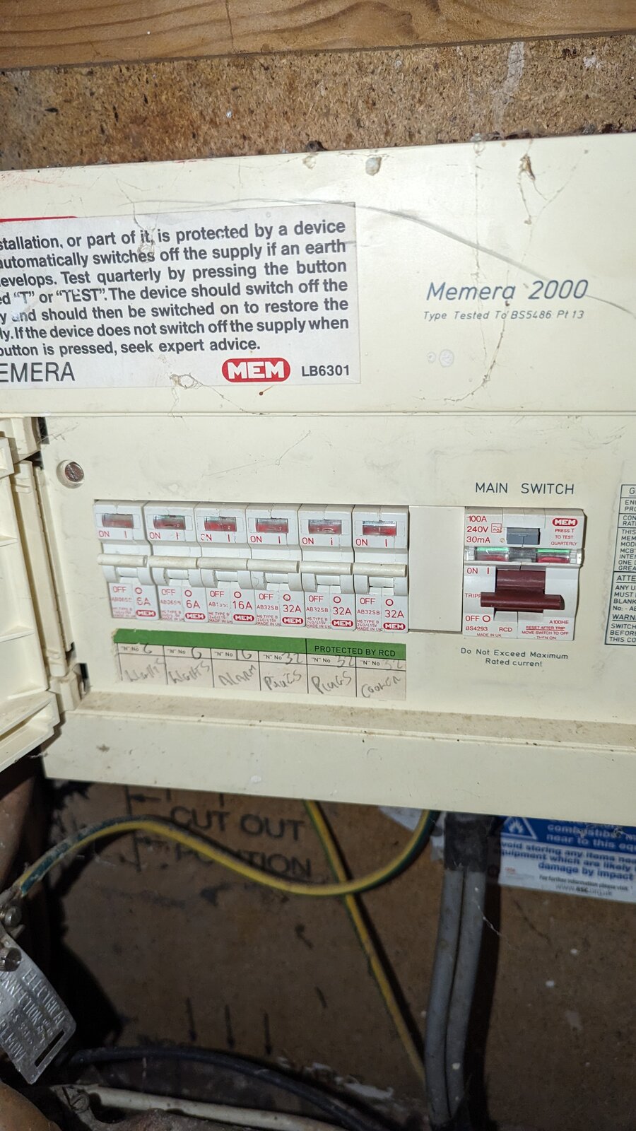

I have a memera 2000 and the RCD switch is in the off position and won't reset. I have turned off all of the plugs in the house, and tried turning the individual switches off on the board and tried to reset it each time. When it tripped I wasn't doing anything unusual and hadn't just turned anything else on or plugged anything else in. Is anyone able to advise a way forward? I've attached a picture as it currently itls

Some faults can trip a RCD even with the MCBs turned off. This is because MCBs are normally only single pole and there is often sufficent voltage between neutral and earth to cause a RCD trip.
It's also possible that the RCD is simply faulty. I don't think memera 2000 parts are made anymore, I think there may be some compatibility between memera 2000 and memshield 2 parts which are still sold albeit at rather high prices but I'm not 100% sure.
I would say the next step is to disconnect the neutrals from the RCD, either by disconnecting the connection from RCD to neutral bar or by disconnecting the individual circuit neutrals from the neutral bar. Then see if the RCD will reset. If it still won't reset with nothing connected that says you have a faulty RCD. If it resets with nothing connected that points more towards a fault on one of the circuits.
Be aware that unless you have a seperate isolator, the incoming tails will always be live. If the board has been installed well then it should be difficult to touch live parts with the main switch off even with the cover removed, but if the board has been installed sloppily this may not be the case. If you cannot isolate elsewhere then you should excercise *extreme* caution when removing the cover from a consumer unit.
Memshield 2 accessories do fit in Memera 2000 and Memera 2000AD
(But not the other way round)
The spikes on the busbar comb are bigger on Memshield 2
This is especially convenient with RCBOs. There are plentiful supplies of Memshield 2 RCBOs (not least on my shelf )
