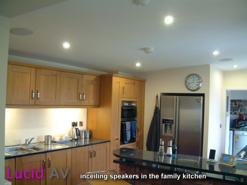

One area that's unlikely to be crowded is the ceiling. Have you considered installing speakers there? If you're prepared to go through all the mess and hassle installing in filing cabinets then a ceiling install would be a walk in the park by comparison.
