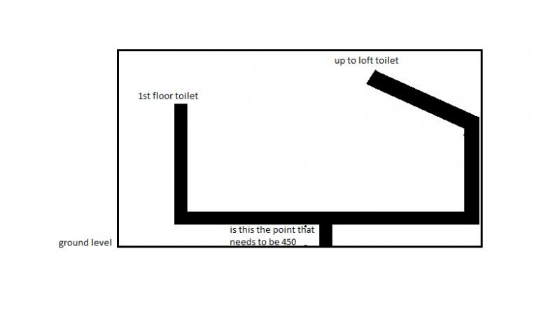

I need to put a double branch into my soil stack near ground level and just wondered if there was a minimum height it would have to be from the ground. It will eventually be going under a floor as i'm extending out where it is, hence the reason it needs to be near to the ground.
