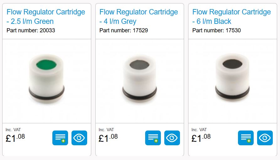

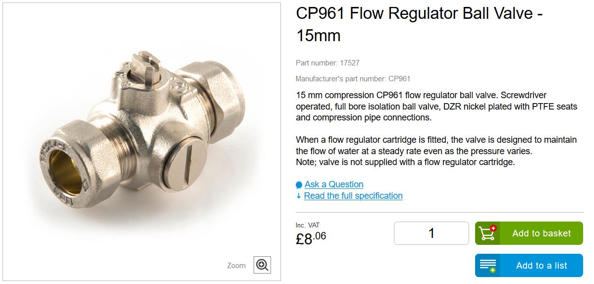

The ideal is to use a dual flow basin mixer/mono tap, then the water doesn't mix in the body where balanced pressure is important, it mixes at the end of the spout. Not a huge selection to choose from though.
https://www.bes.co.uk/flow-regulato...Xpvm7yMvwNsVs2cugBpfnVSorf0J0mrQaAlqDEALw_wcB
