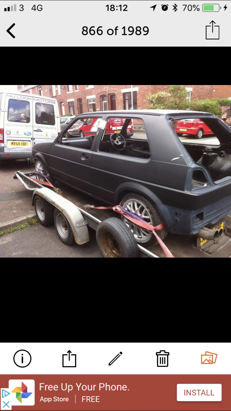

I have a Mk2 Golf too, it's a K-reg with an R32 engine in it, it will get finished when I retire :LOL::LOL:(y)

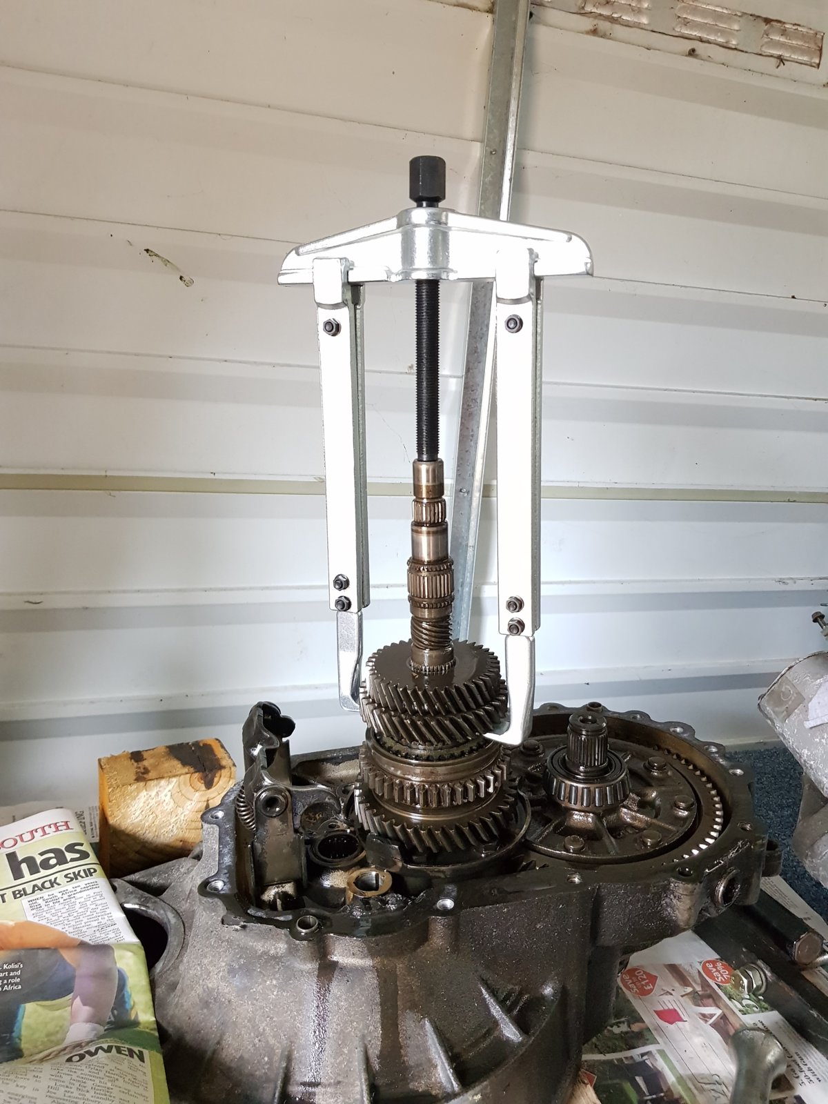

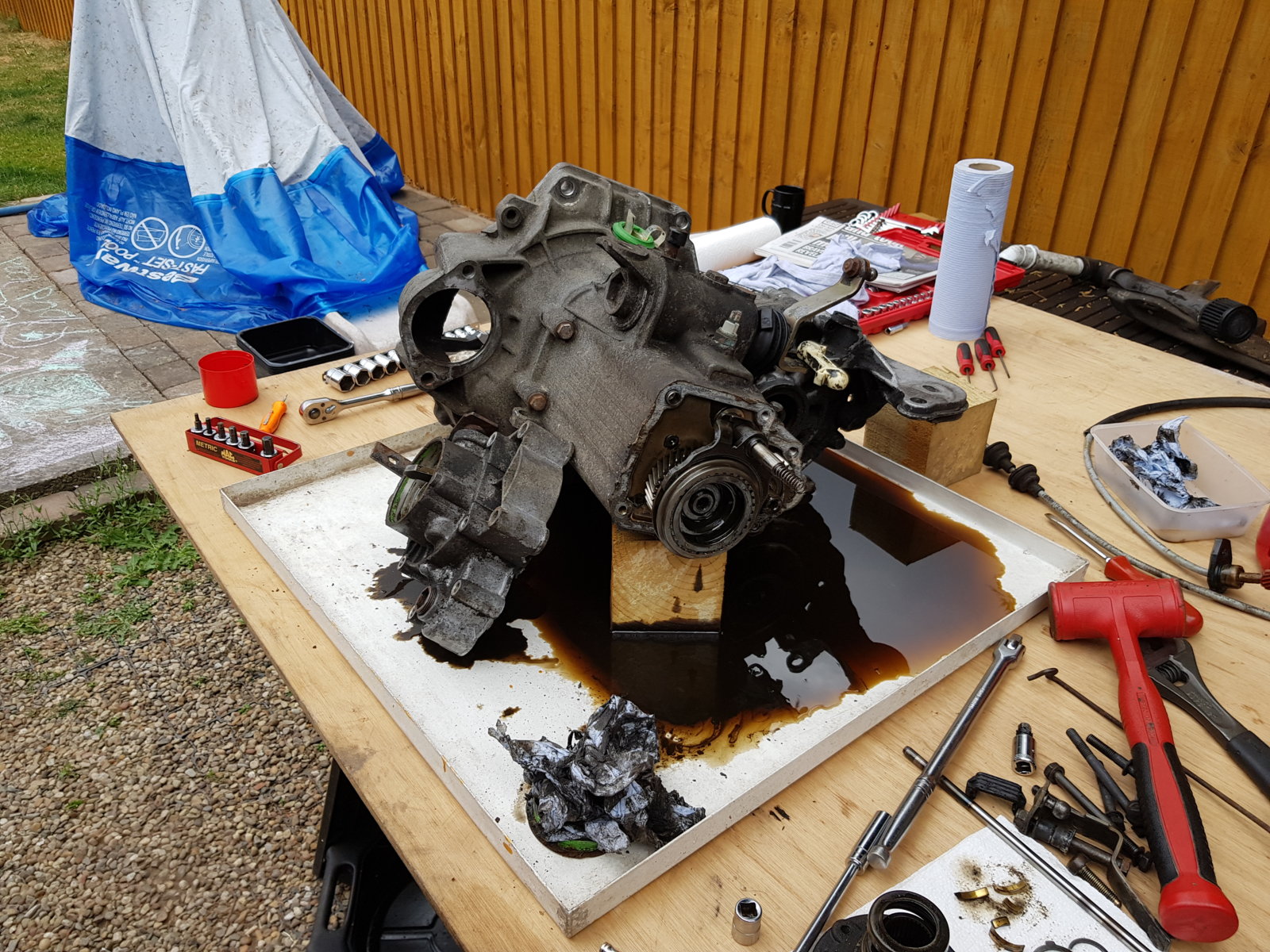

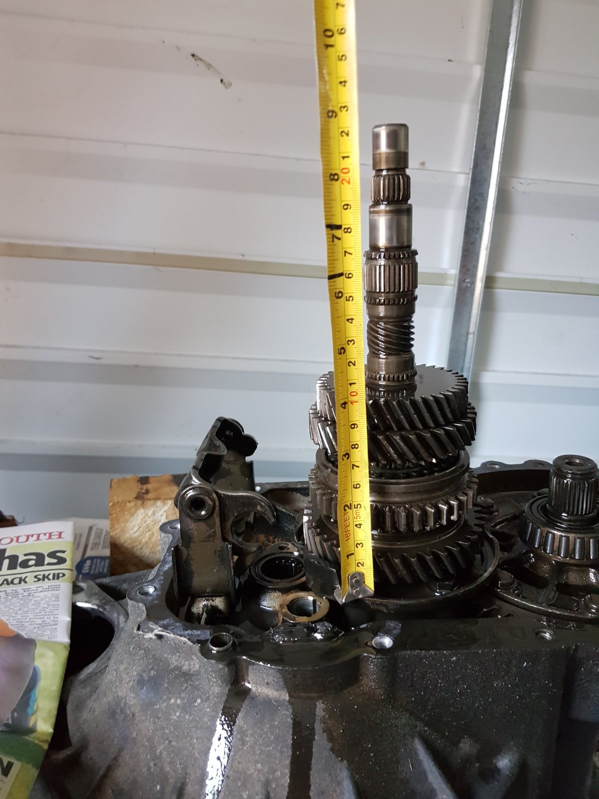

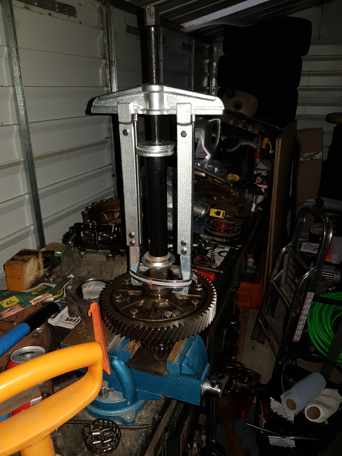

Managed to muddle through my gearbox strip today, unfortunately I need a specalist puller to pull the output shaft cluster off to remove the diff, nowt's simple!.

What are you doing with the gear box? LSD ?

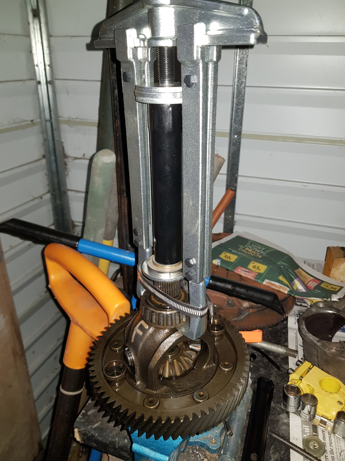

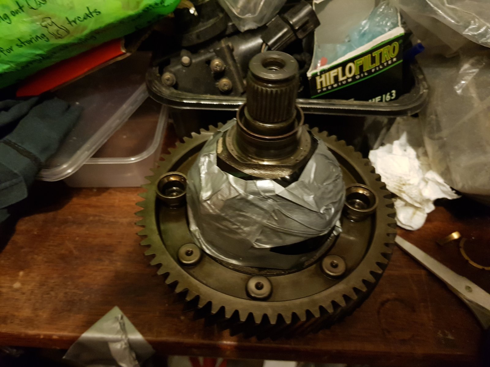

For now it's a strip to check condition and I'm drilling the diff rivets out and fitting a diff bolt kit (common failure on the 020's).
Would like a Quaife LSD in the future so any tooling I have to buy will be used again!.

Puller turned up today, need to make some spacers though.
Got a Peloquin Pelolock 80% diff kit on the way as well for a good price!.

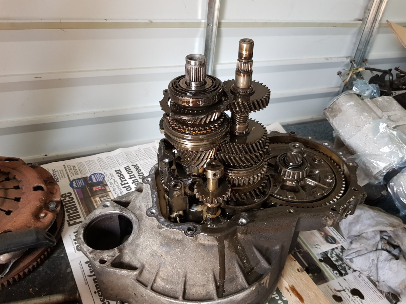

Shafts out and diff bearings pulled and diff ready for rivet removal on works drill press.
All taper roller bearings need changing, requires all preloads setting up again unfortunately (shims under bearing cups).
All gears and shafts look good though!.

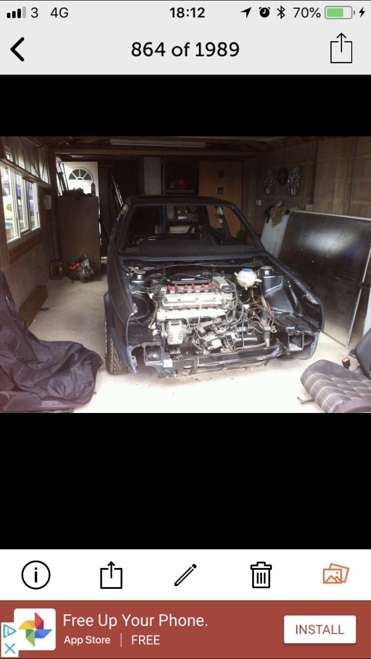

Got a set of R6 forks to build for a friend but he's also giving me a hand to pull the engine out so favours for favours!.
Yours looks like a lovely restoration and a fair old lump to cram in!
