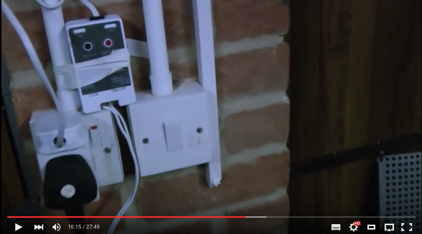

Because when I was younger, I was mad on X10 automation and wanted everything including the garage door :notworthy: to be controlled with X10. Even could open the garage door from anywhere in the world. :?::cautious:
What you see in the picture is the X10 relay hooked up to the motor of the garage door.
I totally understand the home automation desire, once I'm happy on a system, I will likely look at taking the plunge. However, I was referring to the method of fixing it to the conduit. I mean, at least you used white tape......
