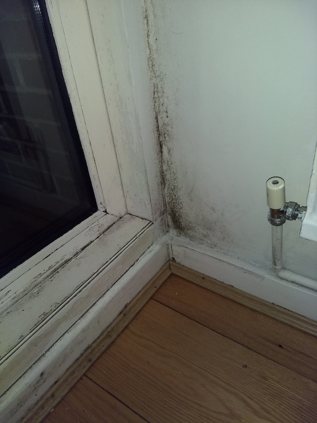

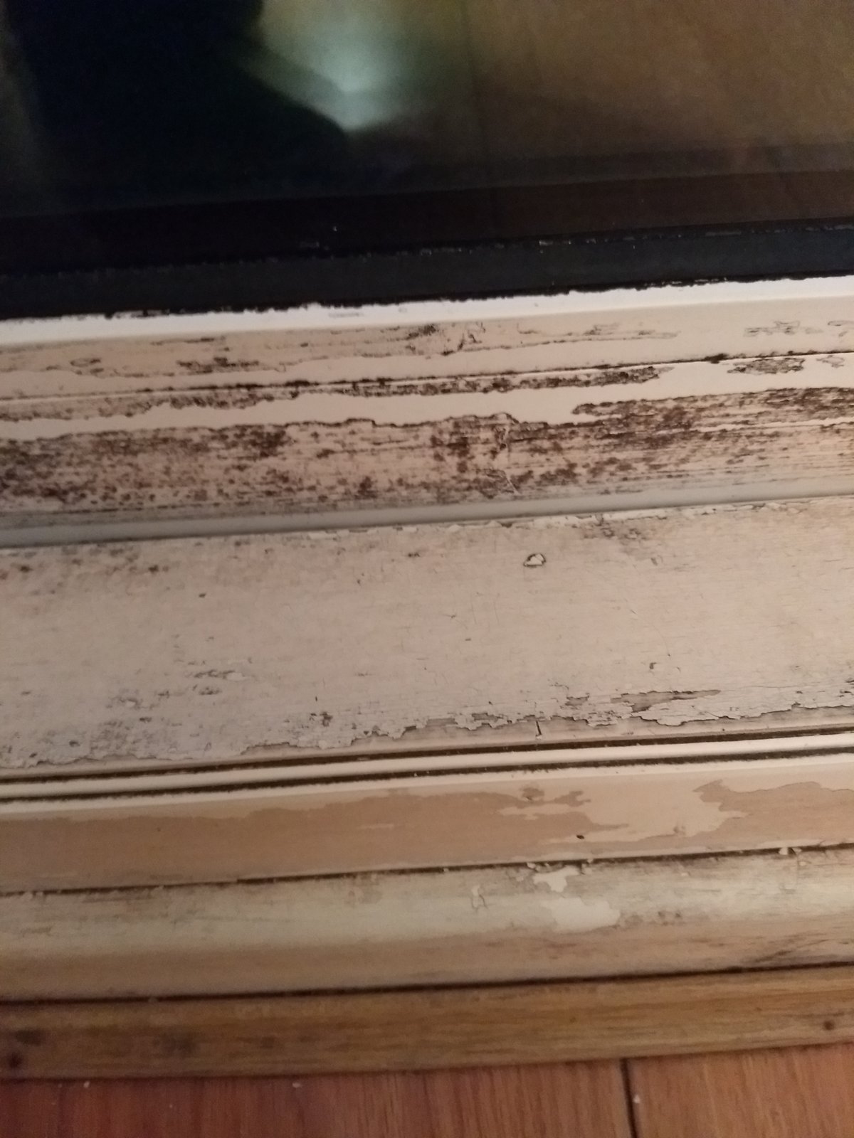

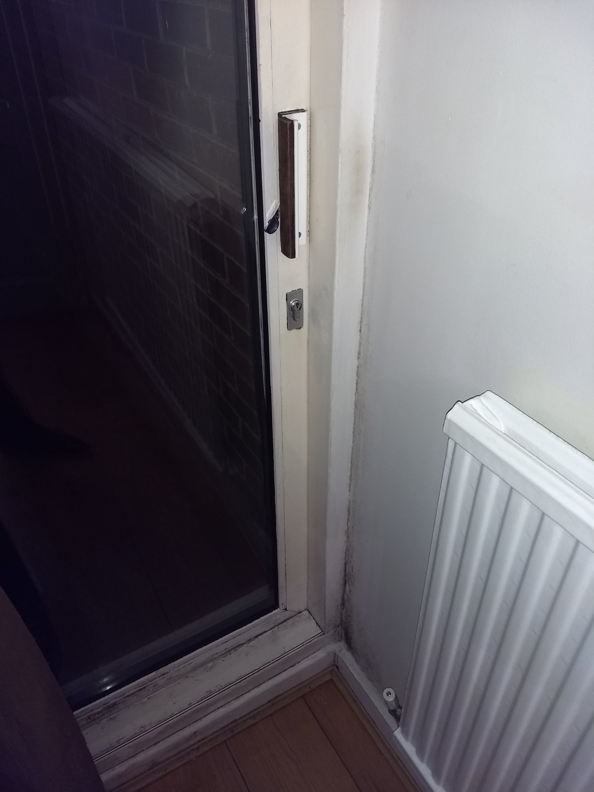

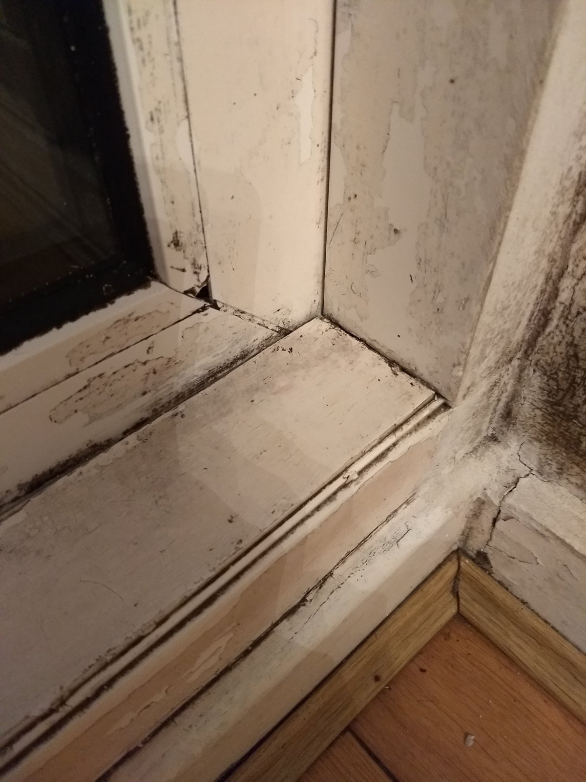

Mould has grown on the inside of our patio doorframe. The back of the curtains are now f***ed - stained and a bit grimy.
I'm assuming I can clean up the black mould and then paint over any discolouration with mould-resistant paint, as a quick short-term fix?
I know it'll come back though, so I'm unsure if the construction or material used for the doors is substandard, or if the airflow in the property would cause this no matter if it was replaced.
Any advice gratefully received. Pics attached for info

The mould is caused by
a) High humidity condensing on cold surfaces.
b) Lack of air circulation - especially if there are curtains drawn across in front of the door/window.
A good clean with mould remover will kill off the surface mould and repainting with anti-mould paint will help.
The mould will return if the conditions persist - mould spores are present in the air and will always grow if the conditions exist.
