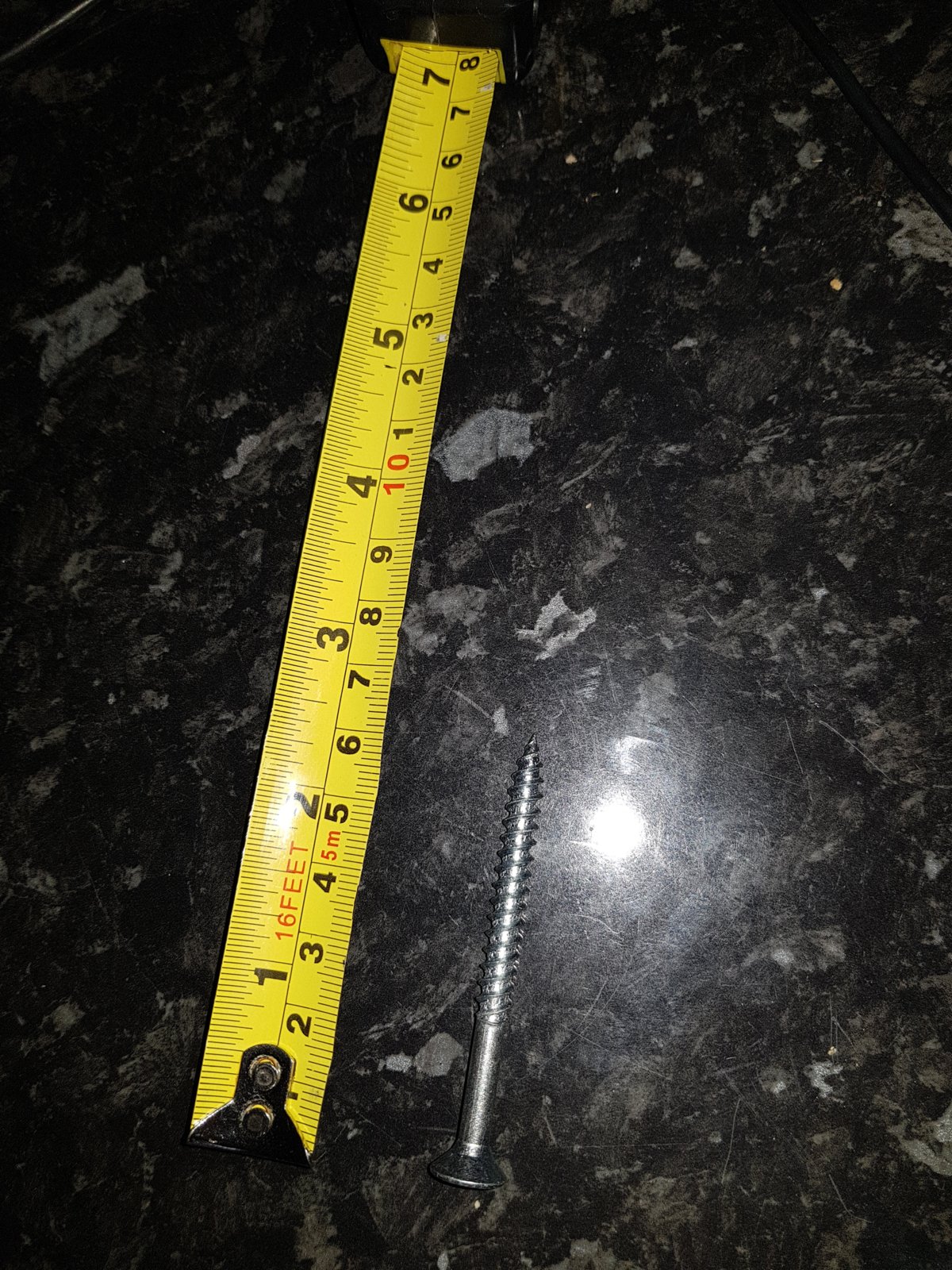

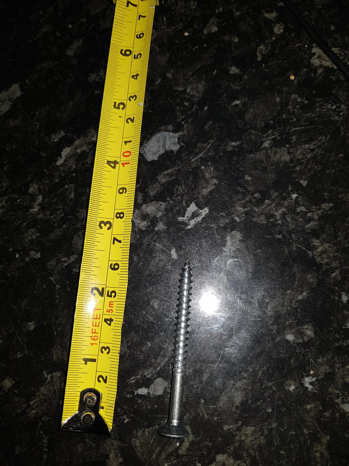

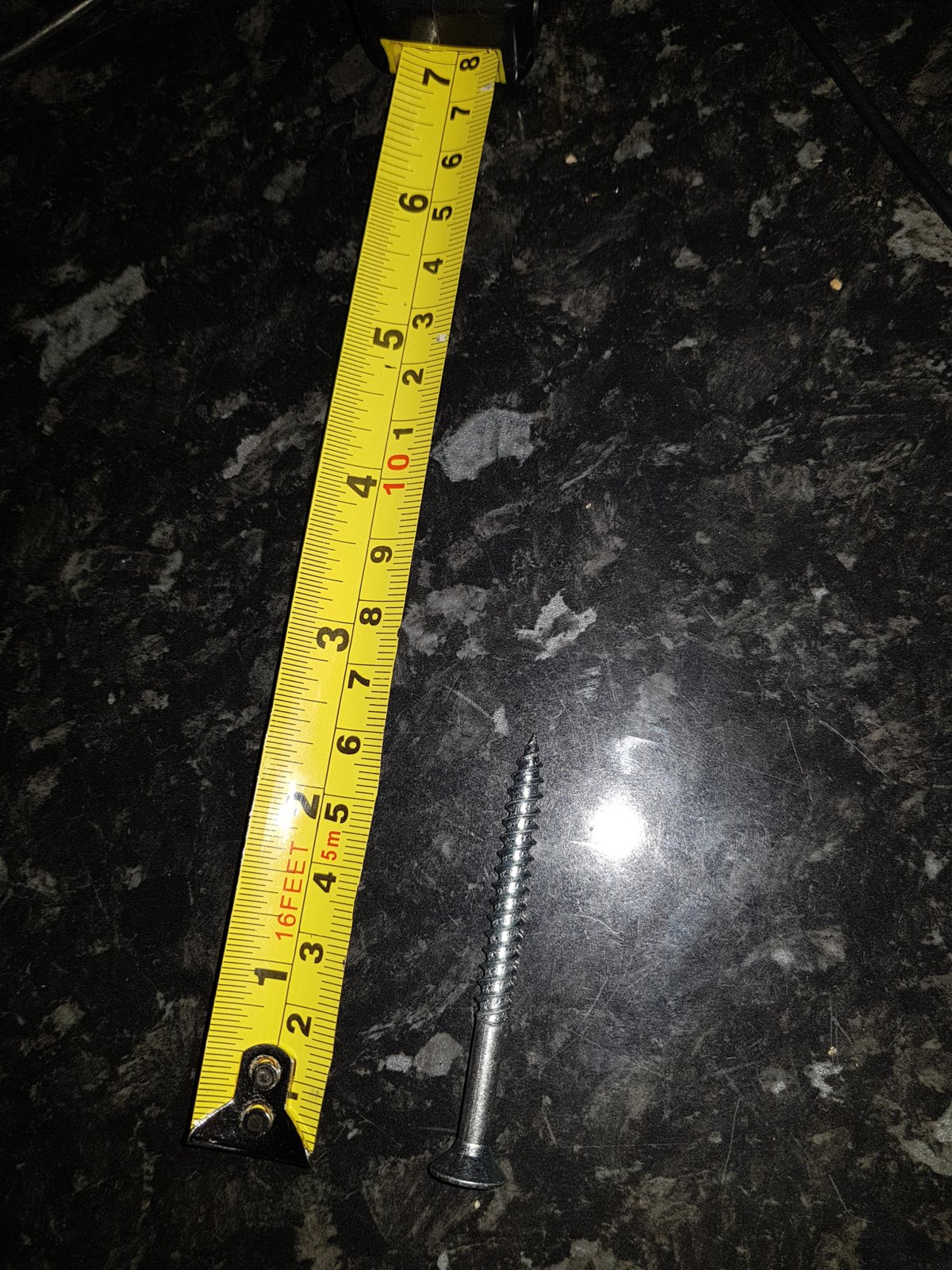

What screws should I get for attaching board to joists. How long and or thick etc. I don't want the board to come down

I have located the joists. Plan is to use the plywood board to span the gap and attach the plywood board with the mount already attached to the joists.
I assume 3 screws each end of board into joists will suffice. I will be sitting under projector so don't want the thing coming off ceiling
Are there are any specific wood screws I should be using. Looking online there seems to be loads of various types.

I’d use bigger standard wood screws about 2” long-esh , the thicker ones too
Do a pilot hole but not to big of a drill bit , then put some muscle into driving in each screw so you have total peace of mind that each one could hold the weight of a man ( this method will only need 1 screw each corner & will be very strong )
You’ll defo be thinking each screw could hold the weight of a few men easy as your sweating tightening each one up !
( or should be )
My projector was expensive + it’s pretty big & heavy , when extension built this is what I’ll do
screws look good, when you screw make sure your getting a good tight firm fix,
I would have gone for the thicker ones to be extra safe, but as long as all tight when your screwing in it should be solid
change to thicker screws (the ones I have in mind are those wood yellow-ish/copper looking ones) if you don't feel confident that
they are not super tight, do small pilot hole
