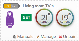

Method 3 fit TRV heads which show target and current temperature and tweak the valves until they match.
