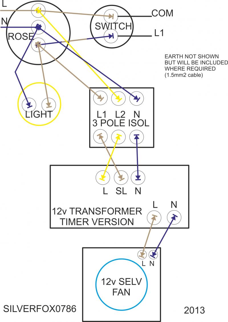

got some work im getting done and being the sort i am i like to plan plan plan before i look into the work itself
i will be getting a sparky to do the work dont worry. being a perfectionist and nosy git i like to know whats going on rather than trust the profesional to get on with it (Sorry) that just me
so i am gettign a 12v fan fitted and decided to do a wiring diagram so i have a clue whats going on
i was hoping someone could look in and tell me if i hit the mark or if im way off
thanks
