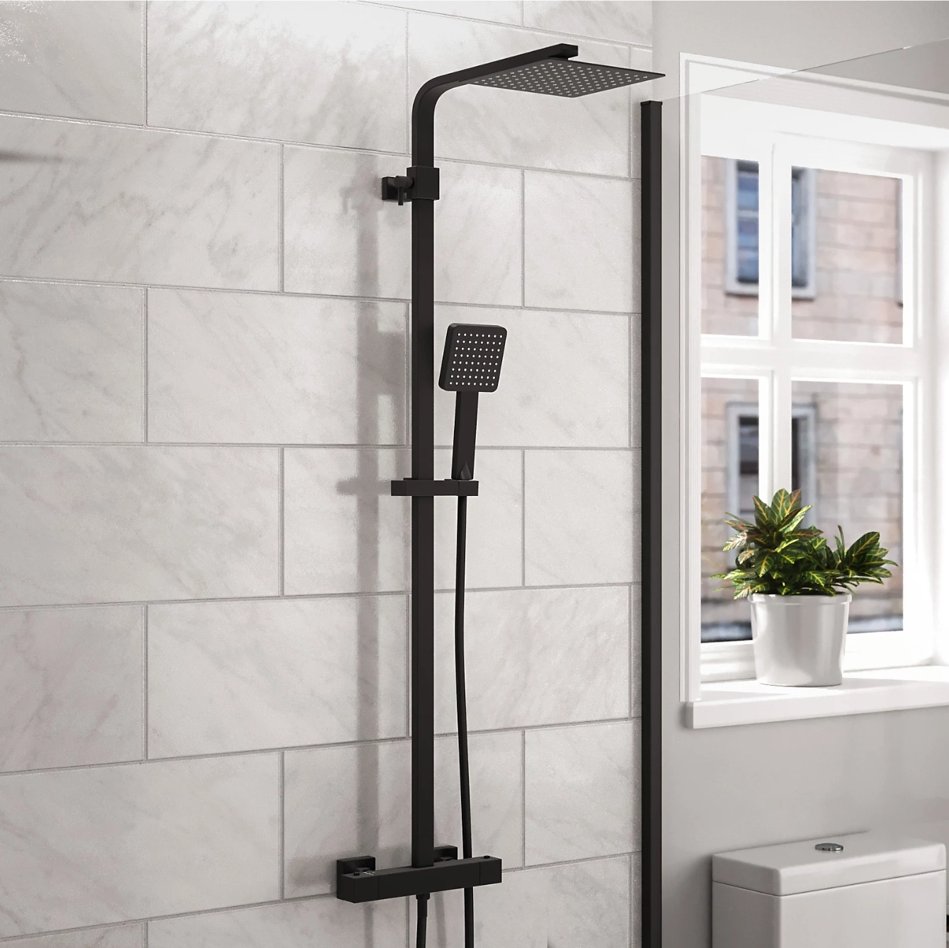

The shower head to the CWSC is 0.5m away.
The shower I'm going to install is nothing special. Here is the link https://www.diy.com/departments/nes...hvXTBJTi-dU3aSUt21EaAl69EALw_wcB&gclsrc=aw.ds.
If 1.5bar is enough, then I'll just go for that instead.

Sorry, I have just attached a photo of the shower.
And I'll probably go for a 1.5 bar then. There is only 2 of us and we won't be showering at the same time.
Thanks for your comment. I really appreciate it

Yes - a 1.5bar pump will feed that without issue, though given it's a rain shower then you may have problems getting enough gravity flow through the pump to activate it - rain shower heads are notoriously restrictive to flow.
@ 0.5m head, you may need to fit a universal pump.
Okay. What do you mean by Universal Pump? When I type that into Google, the same pump I've been looking at shows. (Salamander and Stuart Turner)
A universal pump is one that can deal with either negative or positive pressure due to the pressure vessel it uses - a positive pressure pump may struggle when the available gravity head of pressure (height of water in cold cistern above the outlet) is low.
Universal pumps tend to be more expensive too. If you can stretch to a monsoon then go for one of them, if not the ST shower mates aren't half bad but only run the shower from it.
