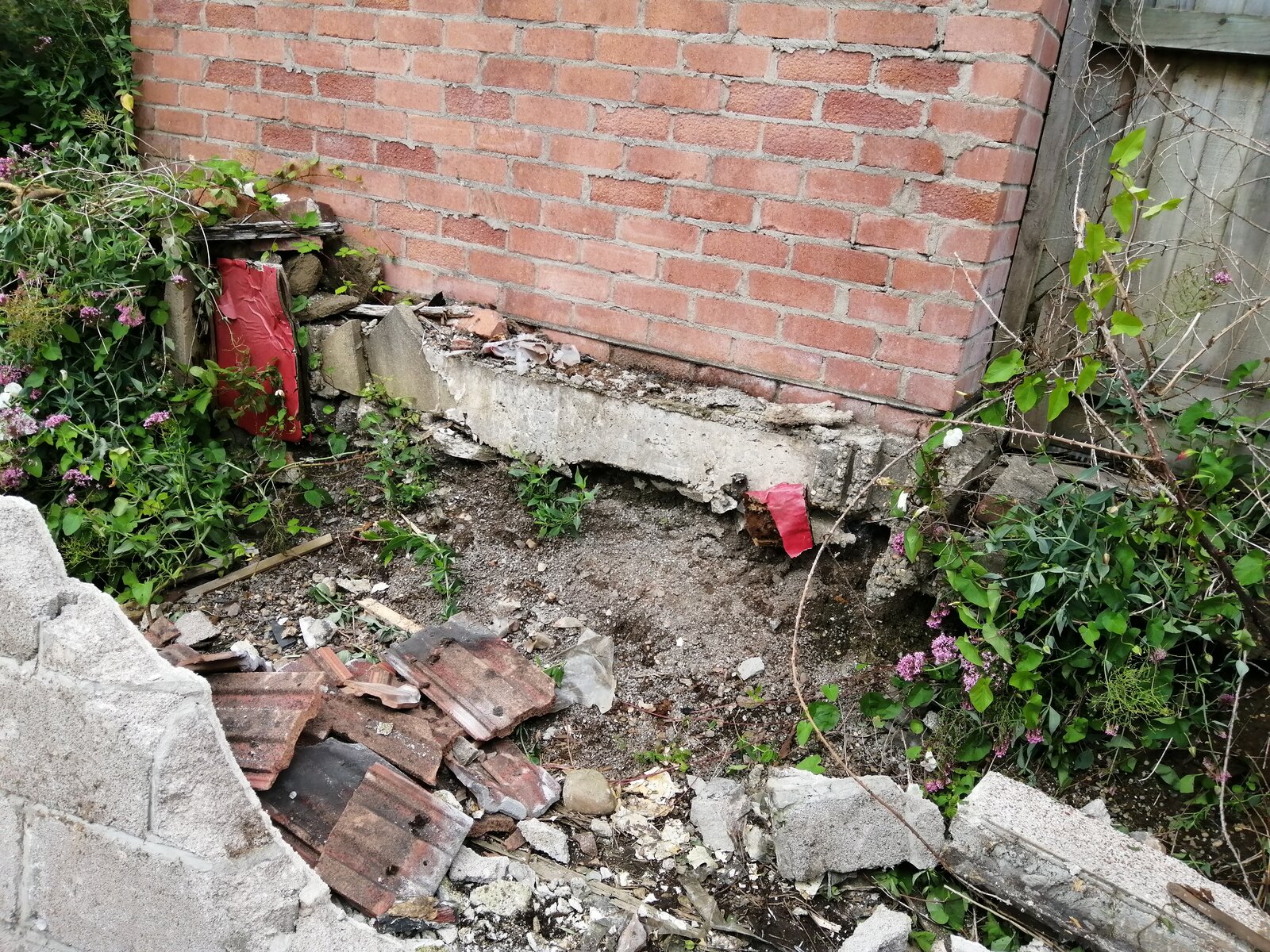

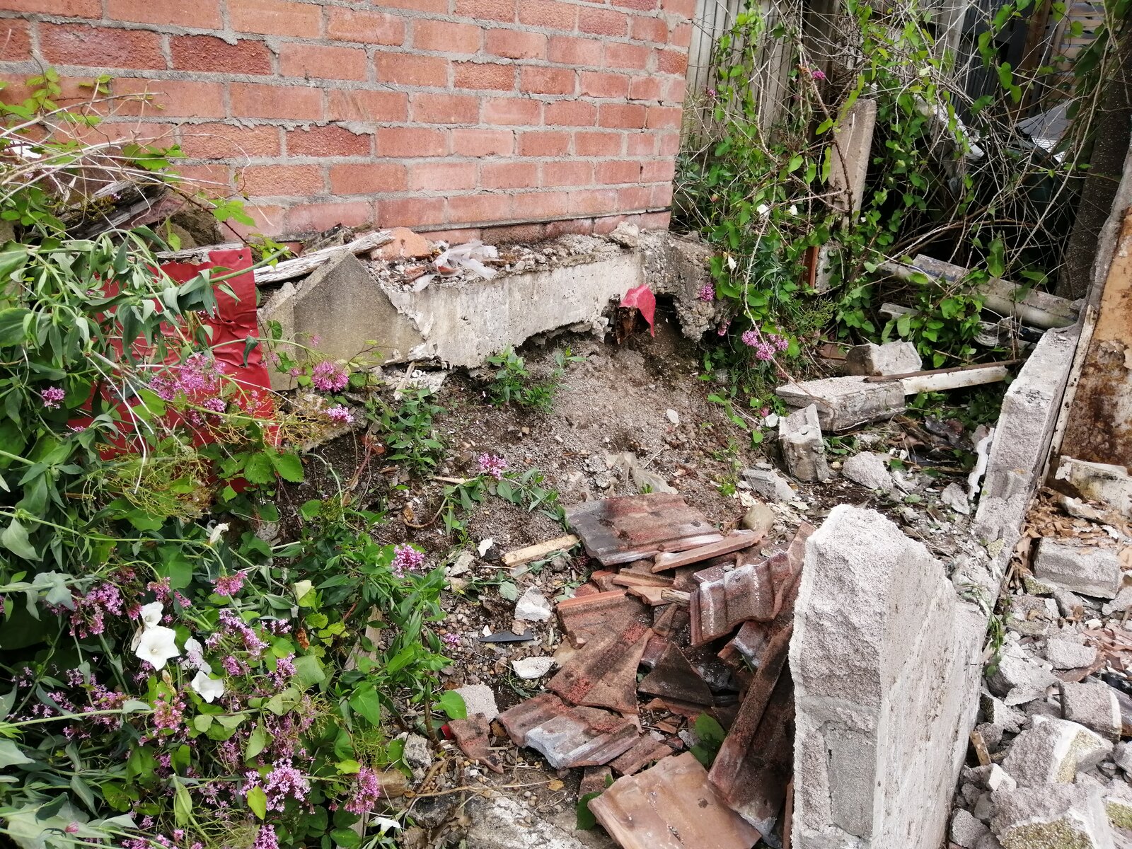

1) Garage foundation doesn't look safe?
2) It's right on the boundary. Are they within their rights to do this?
3) Best way to solve it. Build retaining wall and fill with cement to secure the soil underneath existing concrete?

Given that there is crap between the foundation and the fenceposts which I assume are on the boundary, its not encroaching on you.
TBH you need do nothing except tidy up your land for whatever it is your doing there.
There may be "a duty of care" and "right of support" involved
http://www.boundary-problems.co.uk/boundary-problems/easements.html#Right of Support
The right of support can also apply to ground (as distinct from a building) that is in danger of collapse as a result of excavation on neighbouring land.Thus a right of support also exists in the case of retaining walls that coincide with a property boundary.
Right of support is covered in the "Truss covenant":whistle:
There appears to be no duty of care or right to support issue there, it looks like the OP has not removed anything.
It's the neighbours crappy support building for their own garage, they are the ones that had the duty to ensure that their foundation is well supported.
It would have been better to build a small wall there to ensure the earth under the foundations stays there given the difference in land levels.
Totally the neighbours problem.
OP, you could be neighborly and let them know what its like now and that it may get worse in future.
