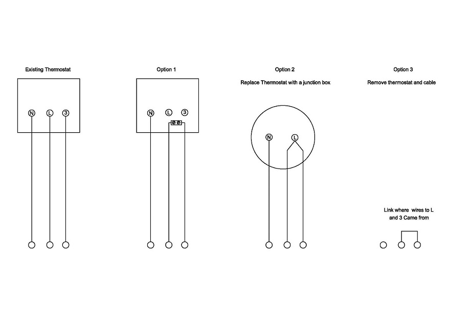

Am replacing Drayton LP722 programmer and RTS1 thermostat. Confident about the programmer not sue on the thermostat. Can trace rts1 cables back to Drayton Lifestyle box. what do i need to do next?

That leaves the RTS1 thermostat.
It cannot simply be disconnected as the heating wiring would be left 'open circuit' and the heating will not operate. Here, you have some options: (Option 3 would be the most professional)
1. Leave the existing room thermostat in place. Remove the wires from 'L' and '3' and join them together in a separate connector that you can tuck away in the corner of it.
2. Remove the existing thermostat and replace it with a junction box. Connect the wires that came from 'L' and '3' together and isolate the neutral.
3. Find the origin of the thermostat cable. Note where the wires going to 'L' and '3' are connected and disconnect the cable, including the neutral. Then link the terminals where the wires going to 'L' and '3' previously originated from.
