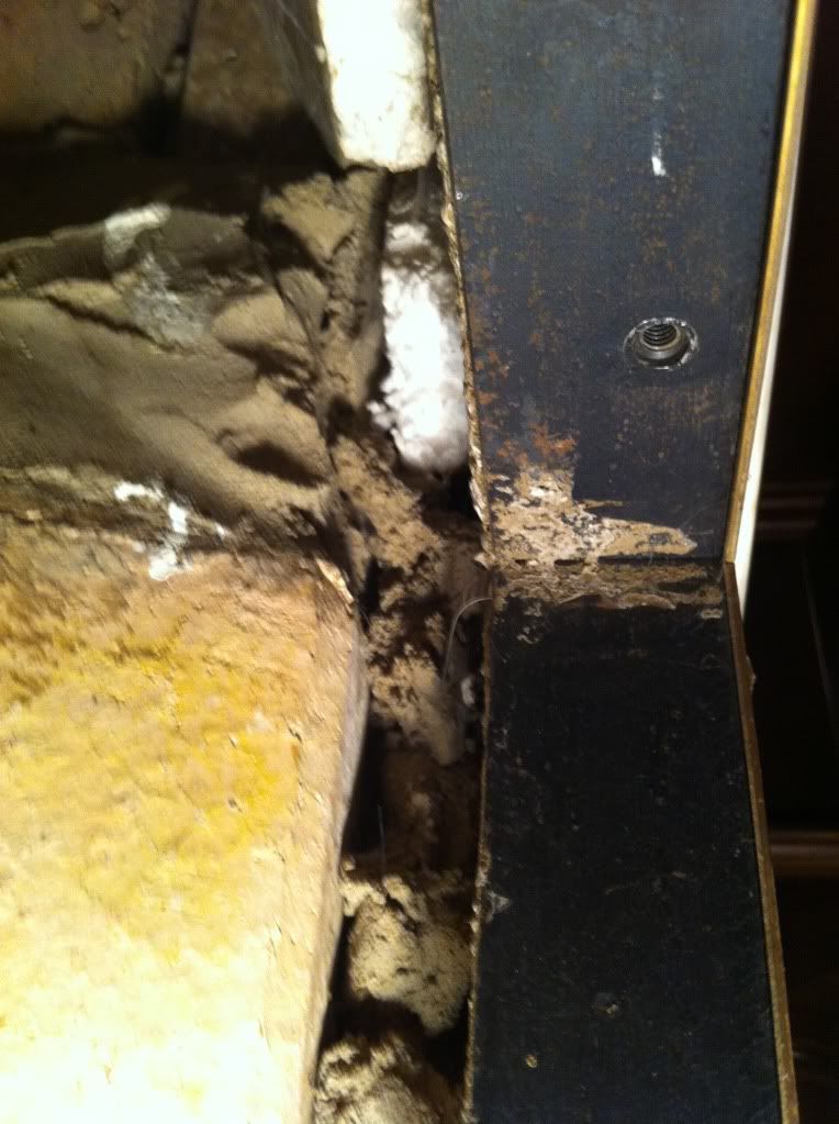

Hi folks.
First post on here and I really hope someone can help me.
I want to use an existing fireplace for a real fire. There's never been a real fire there before, just an electric insert. The house is reasonably modern, about 20 years old.
I went out today and bought a grate and some fire cement as I had notice that there was a gap between the fireplace surround and the fire back (see pics). However I've just had another close look, which included sticking my head up the chimney(!) and was alarmed to see polystyrene insulation sheets clearly visible at the top of the opening.
What do I do with these - break them off sufficiently to enable me to force some fire cement up into the opening? I've tried to capture them in the pictures. I'll try to place these pics in order, so #1 is straight-on view of fireplace, #2 is one of the vertical sides showing the gap, #3 and #4 are looking up, where the polystyrene is visible.
Thanks in advance for any help.
You cannot just stick a solid fuel fire into an existing opening without getting the flue, hearth & other Building Regulation requirements checked & certified by someone competent & qualified to carry out the work (HETAS), read this but by all means come back with specific questions if you need;
