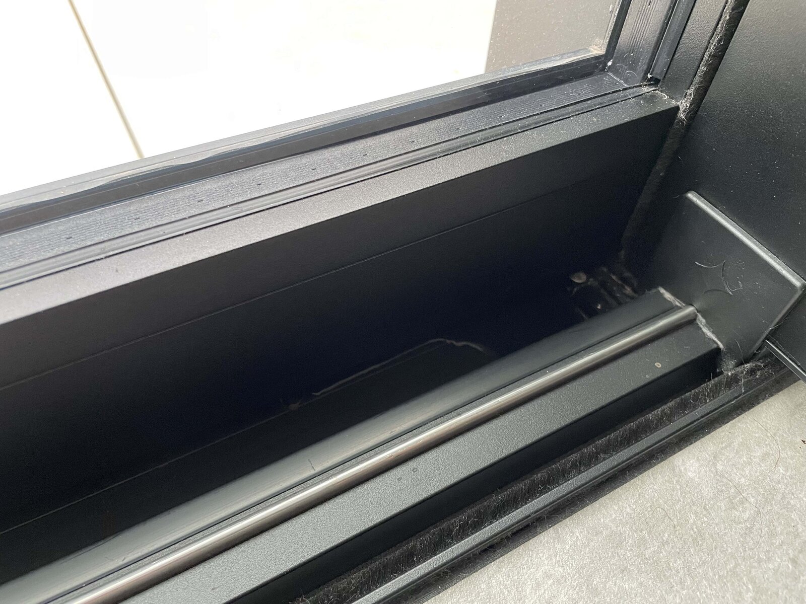

When it rains there is water pooling on the inside of my patio doors. It's always below a point where a door meets another door or where a door meets a fixed panel, as if it's coming in through the vertical joint between them. It does seem to disperse a few hours after rain has stopped but I have never seen this with similar doors in the past. I spoke to the manufacturer who said this is normal (provided it disperses) but I find it a bit disconcerting that doors aren't watertight and I'm just after a second opinion to put my mind at rest if anyone is kindly able to help.

They are sliding doors - 3 of them on the same wall and all have the same issue. It has not rained for 24 hours here and there is still some water in the track, albeit less than yesterday.

My sliding doors get water in the inside channel when it rains against them. But there are drain holes and it disappears reasonably quickly

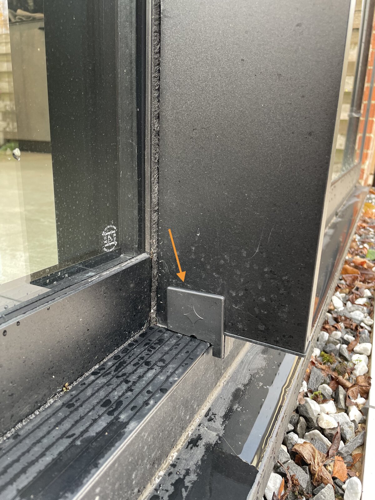

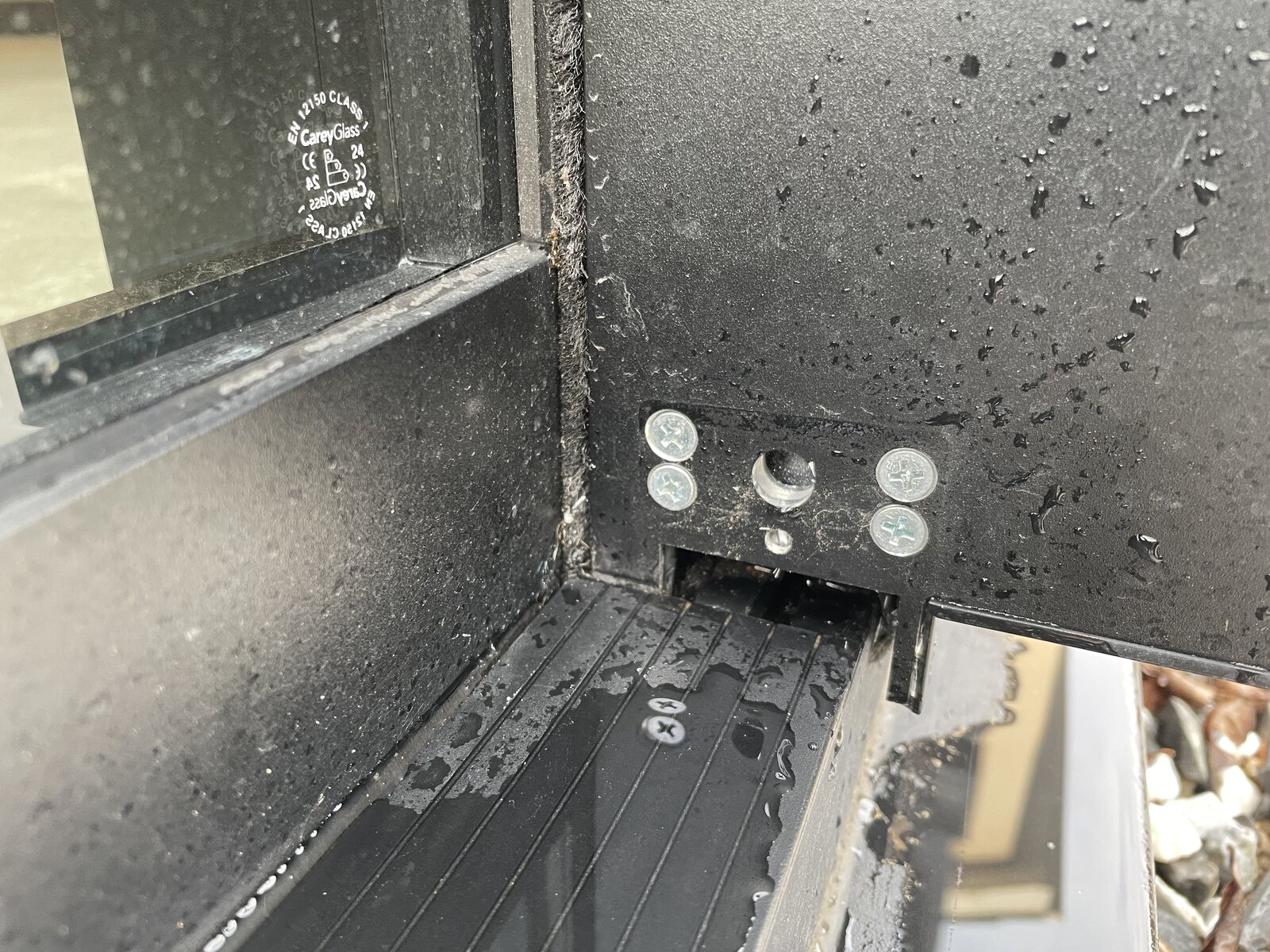

After a few watering can tests I found that the rubber seals, cills and where the door edges meet are all watertight. The problem is with the small plastic trim that hides a group of screws: water goes in the top of it and then travels through the hole in the middle of the frame behind it - perhaps this hole is not meant to be all the way through the frame as it is only there for the lug on the plastic trim to plug into. I'll check back with the installer and see what they say.
Even if this is by design, the water stays in the inside track for hours until it evaporates so at the very least the drain is not working.
