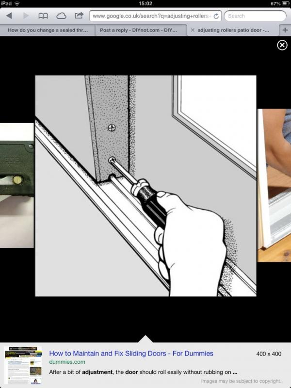

Is it an Aluminium patio?? If so you want to lift the roller up located on the back of the slider at the bottom. You'll need a long pozi screw driver!!
If its pvc you can probably do the same although I'd opt to pack the glass to suit the frame. You may have to move the keeps on the frame to suit the new postion of the door, good luck
Its a hardwood set as per the title. I have edited my OP and tried to make it clearer. It is not the usual wheel adjustment to make the doors slide nicer and to make sure the door sits flat against the frame when it is closed. The problem area is where the two middle frame edges sit against each other. The outer door is tilted out towards the garden at the top so the brush seal between the doors is not compressed.

OK, how is your door hung, form wheels on metal cradle brackets or is it balanced on rollers set into the bottom of the door...pinenot :unsure:
