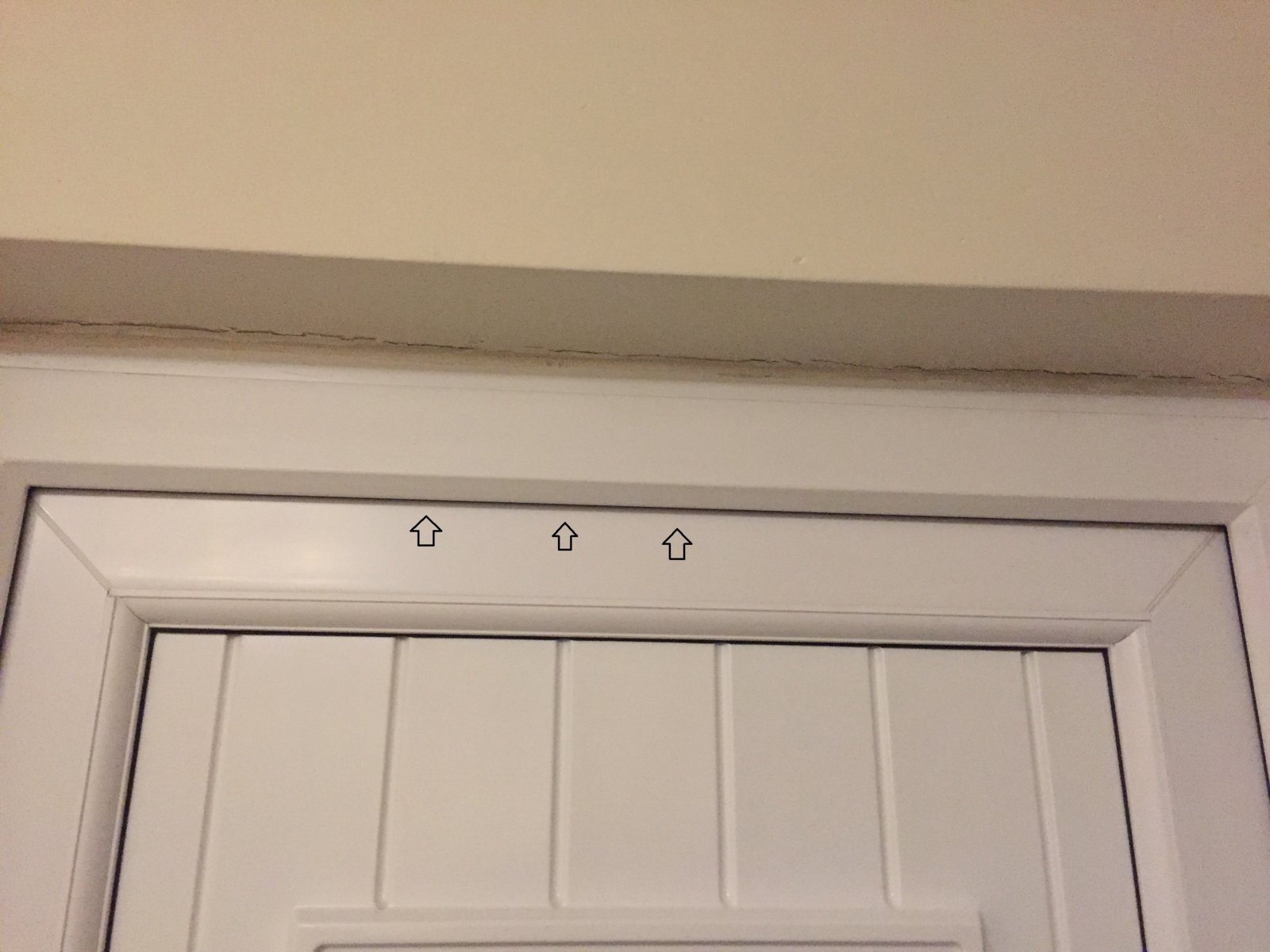

Hi,
I have a back door and over the weekend noticed that there is a gap at the top where the door meets (or is supposed to meet) the rubber seal. I can feel a draft and can also slide a card into the gap. I have adjusted doors in the past to align them vertically but never had to close the gap in this way. Can anyone advise how the gap can be closed?

Hi so adjusted the hinges and the gap is closed now all but the top horizontal part above the door handle. I don’t think the opening side can be brought in anymore. It is just this part, the rest of the seals are flush against the door. Even with the handle up, there is a gap like 1mm enough to feel draught and see the white pvc instead of a black seal

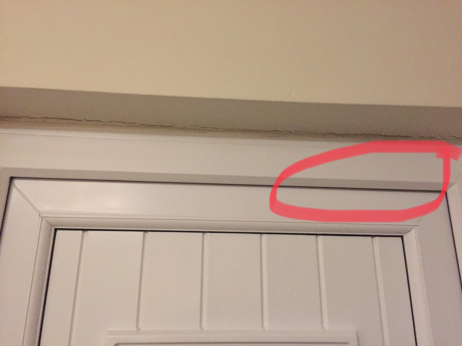

Hi mate sorry hope this explains a bit better
The rest of the door is ok just the part highlighted in red can feel a draft and slide a thin card between the door and seal.
Needs toe and heeling properly,you need some packers/shims and a glazing paddle(or as is only a panel insert you could use a bolster) google toe and heeling,very easy if you know what your doing.panel out,pack the 2 corners and you will watch it lift as you do it,mark around the top corner on the frame before you start and you will see the difference

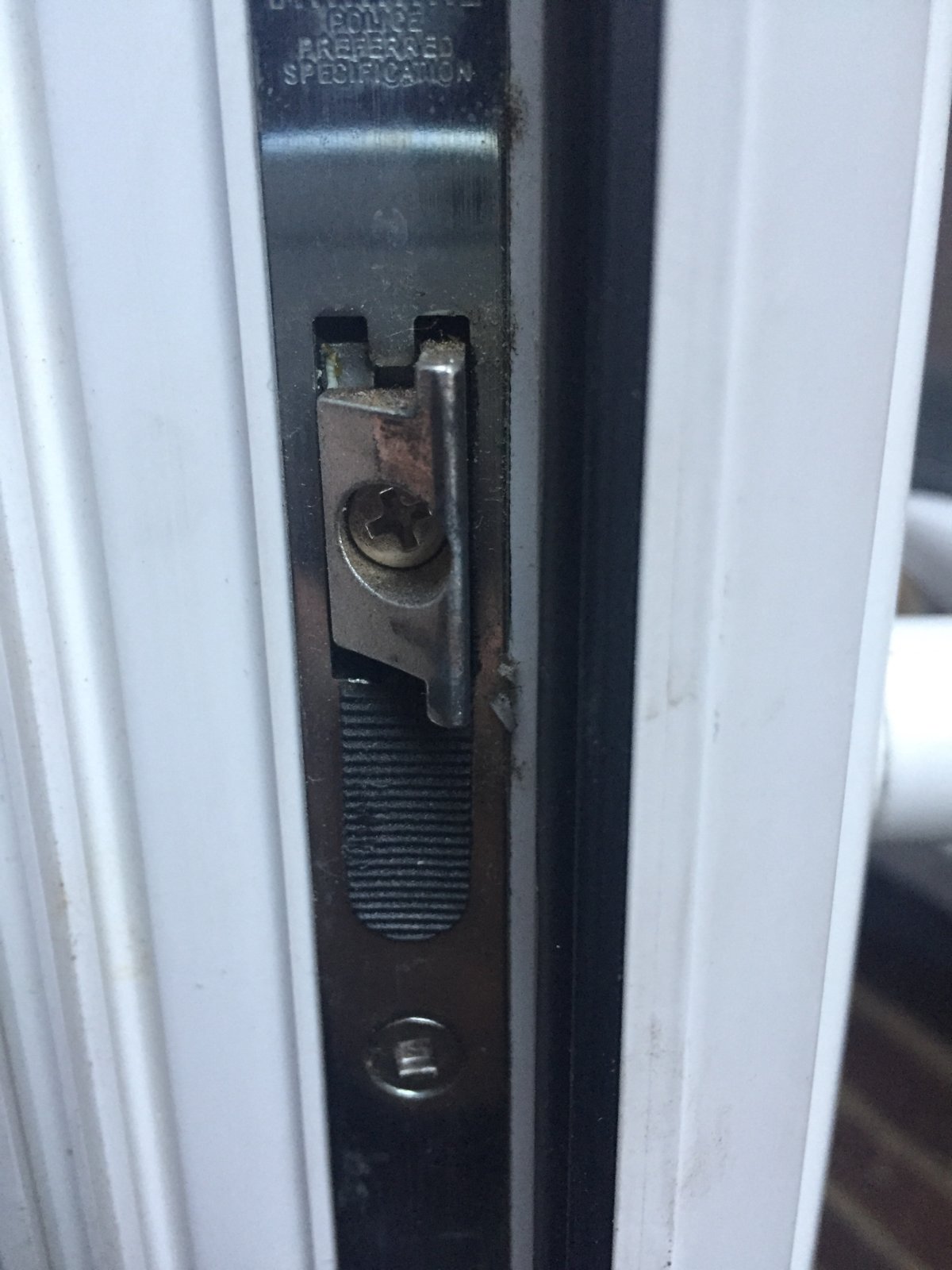

Is there no adjustments I can make to the metal fixing on the inside of frame where the locks latch into?

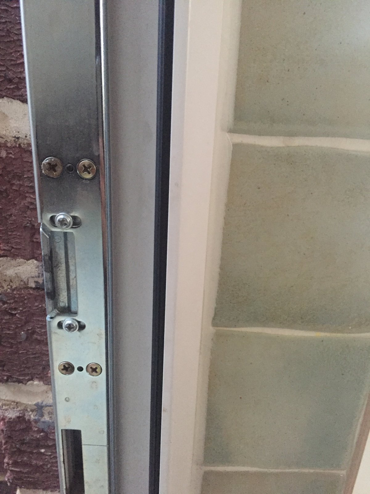

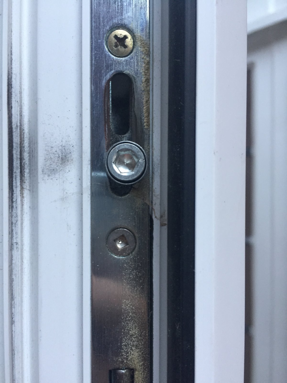

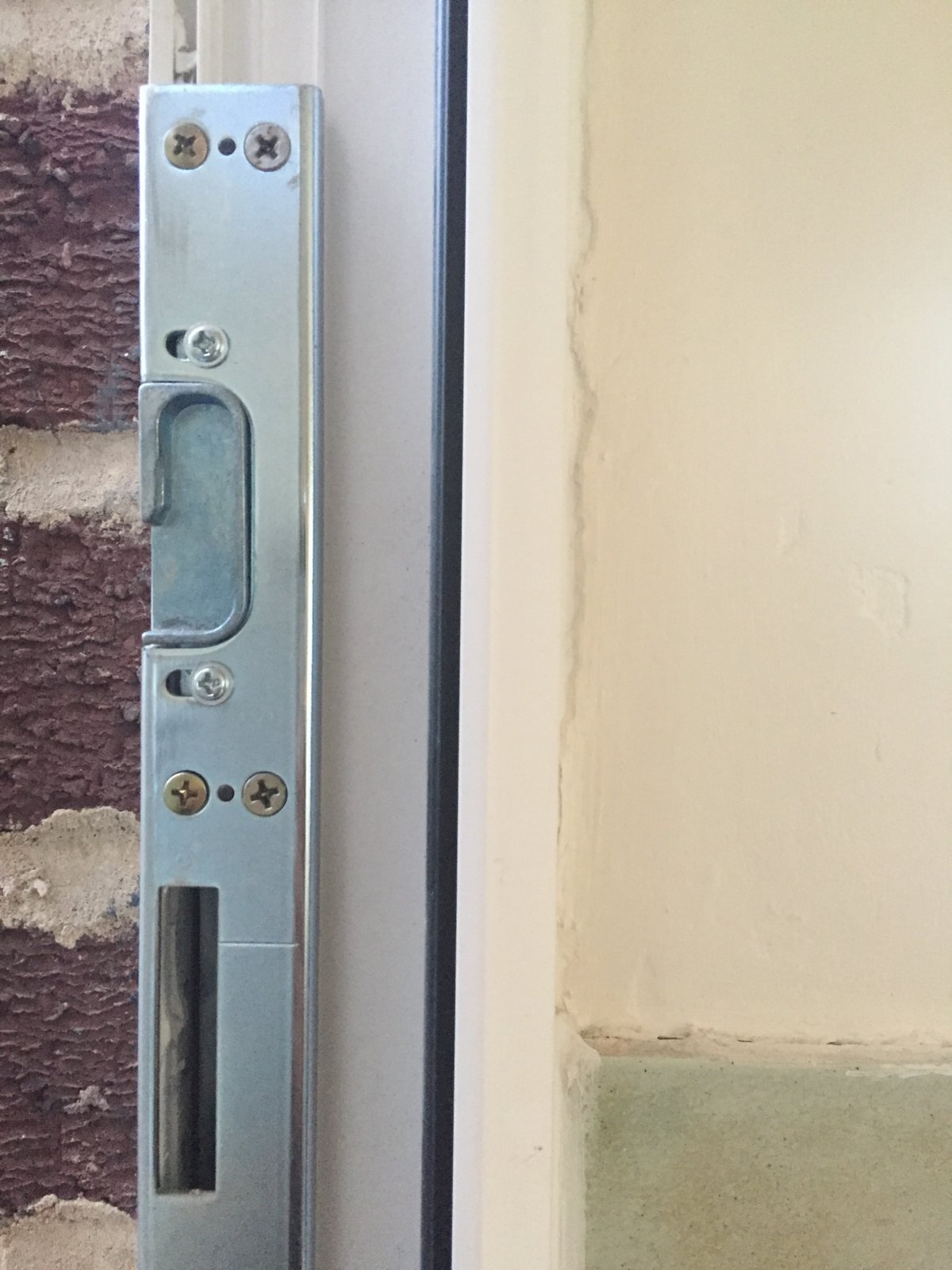

You can if it’s just A case that’s its high enough but not pulling in tight. Send me a icture of your locking part on the door and locking part on the door frame and I will talk you through it
Yes you can tighten that,the keep on the frame at top is as tight as it will go but you can tighten the mushroom cam on the lock by turning it very slightly with an alley key,do it slightly and try it every time so it feels tighter locking but not so it feels wrong.
Also your central keep by the handle can be tightened slightly,loosen the 2 Philips screws and push towards exterior a little at a time then tighten,should be done so it will stay shut when the door is pushed shut,if it bounces back it’s too tight and won’t do a job
