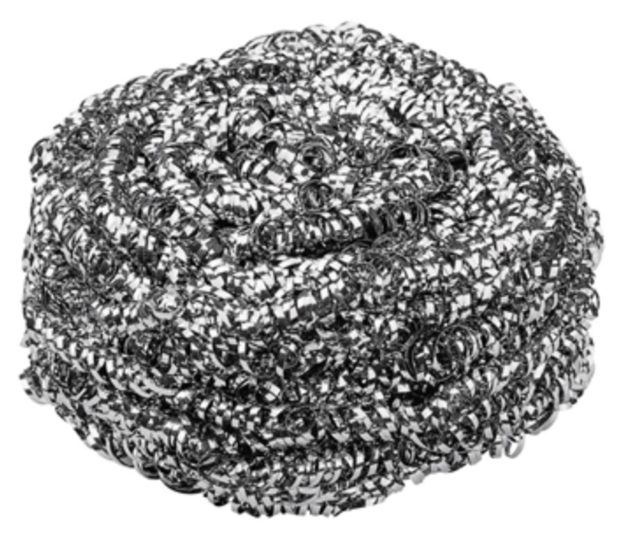

For getting off the little residual bits post scraping, try a coarse wire scourer (after letting the paint stripper sit for the requisite amount of time) instead- clog resistant and acts like a hundred tiny scrapers
I don't usually use paint stripper for the bulk of the work; prefer a heat gun and scraper, but stripper plus one of these for getting the trailing scraps off seems to work well
