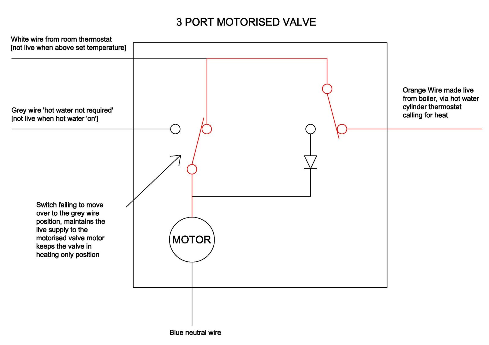

I agree with ianmcd. I think that you have a intermittent fault within the motorised valve.
There are two microswitches inside the motorised valve, if the first one (shown on the left in my diagram below) does not change over as the valve opens it would cause the situation where the valve remains in the heating only position, and the hot water cylinder thermostat will keep the boiler going. The drawing is shown in the fault position with the red line showing the fault circuit. in this position, the hot water port is closed off, so the hot water will not heat up but the heating will stay on regardless of the room thermostat being satisfied.
Turning off the hot water at the programmer will remove the live it was sending via the cylinder thermostat to the boiler which is being fed back to the valve motor via the orange wire and keeping the valve in the heating only position.

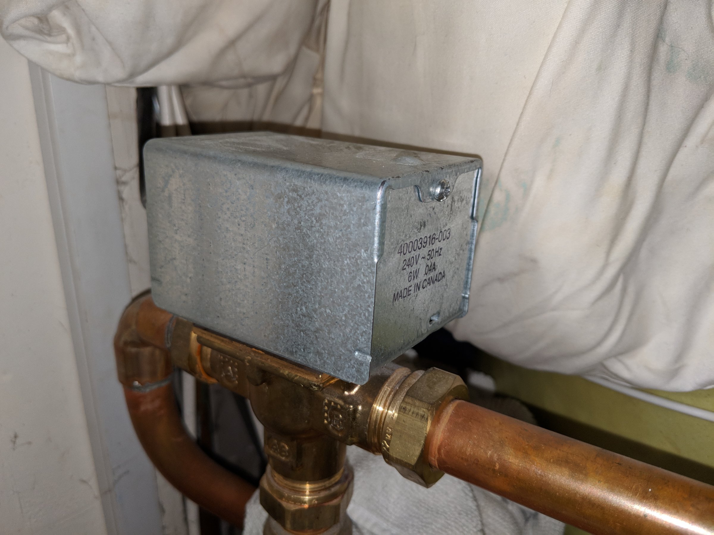

Thanks, both. So this is a valve that is part of the plumbing inside my airing cupboard with the hot water cylinder, the metal box attached to the plumbing, right? So it shouldn't be a terribly big job for someone to come along and replace the valve for me? Thanks.
It will look something like the one in the photo below and can usually be found near the hot water cylinder. It will probably be necessary to drain down part of the system before removing it.
Thanks, all. Does it matter what position that lever at the rear of the box is in? Because as I was moving stuff out of the way and "found" that switch by feel, I'm not sure if I've moved it into a different position or not.
post a pic of the one you have as there are different makes and some you can just change the head without draining anything , some you have to drain
You can change the head on that one, the dimple on the top is the indication of that. However, if the top is old, the bottom would be too, so personally I would change the whole thing. But that's your choice. It's an easy DIY fix just to swap the powerhead over.
The lever should be in the 'auto' position the other position 'man' is there for filling the system only. However, the valve should automatically revert to the 'auto' position as it's used.
