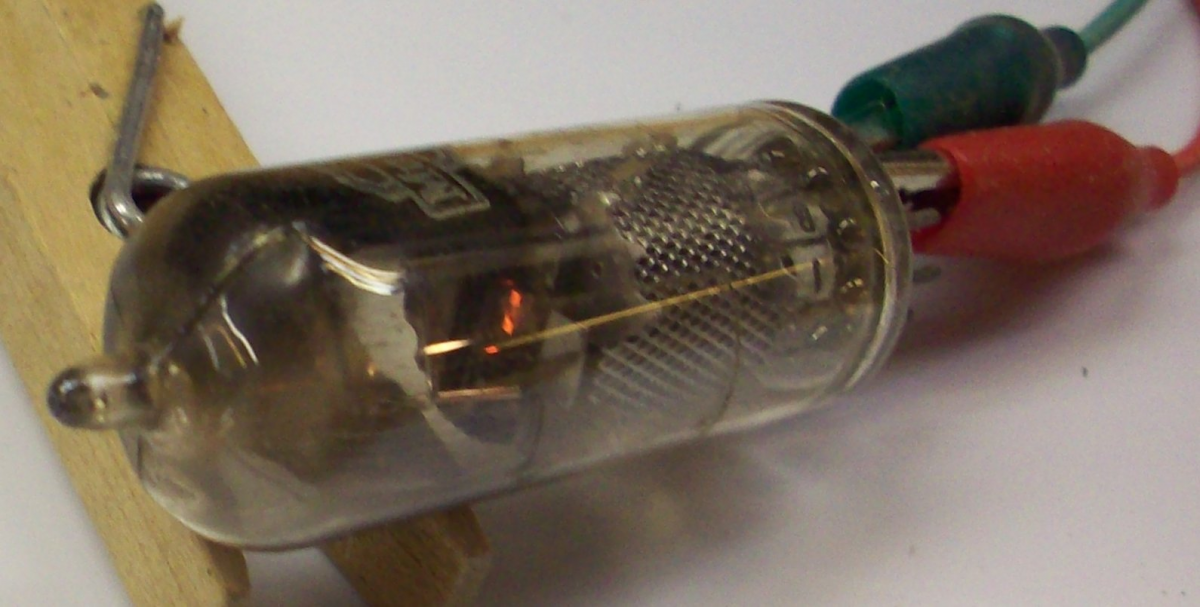

I haven't got a clue as to whether they had greater thermal lags than lamps
Apply 6.3V from your transformer to a 6V flashlight bulb for, say, one second, and what do you see happen? Now apply that 6.3V to the heater of, say, an EF80 for the same period of one second and what do you see?
It's a long time since I looked carefully at an EF80, let alone applied voltage to it's filament for one second (a trip to the cellar may be indicated!). However, I suspect what you are talking about the the cathode of the valve, rather than the filament itself, and the cathode clearly will have a much greater thermal mass than the filament of either a valve or a lamp/bulb (and to take time to be heated by the filament), so one would expect it to take longer to start glowing, and to glow for longer after the voltage was removed.
However, as I said, I don't think that thermal mass/lag has got much, if anything, to do with my point about the peak current!
Kind Regards, John

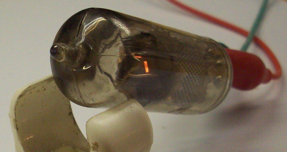

Trip to cellar, and application of 6.3V to an EF80 heater done :-)
One can see just the upper tip of the cathode, and what one can see takes a couple of seconds to start glowing, and continues to glow for a second or two after disconnection of power, but I can't really convince myself as to whether what I am looking at is just the cathode (with the filament hidden within it) or the filament itself.
Kind Regards, John
On most valves you can usually see part of the heater if you look through the envelope at the right angle into the end of the cathode. Another thing to remember is that in many designs the heater is in physical contact with the cathode anyway, so the thermal mass of the cathode is added to that of the filament.

With larger valves, I agree. However, as I said, with an EF80 I really couldn' decide whether or not I was actually seeing the filament, rather than just the cathode. In the second picture, the hotter (yellower) bit towards the bottom of the glowing area could be the filament itself. What do you think? ....
That's obviously true, certainly once the cathode starts heating up. Of course, there is only electrical contact between filament and cathode in a 'directly-heated' valve (which can play havoc with some applications, particular audio!).
