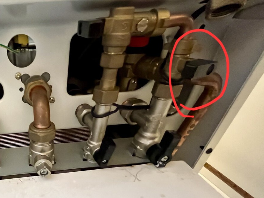

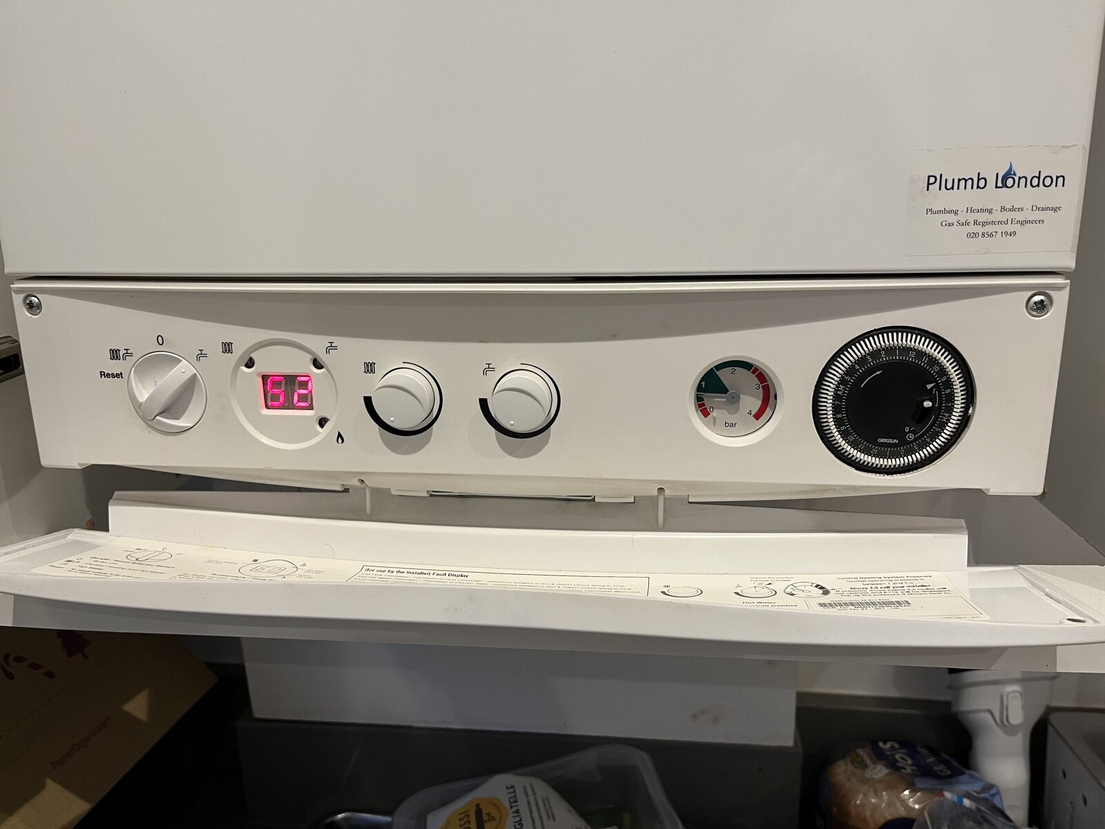

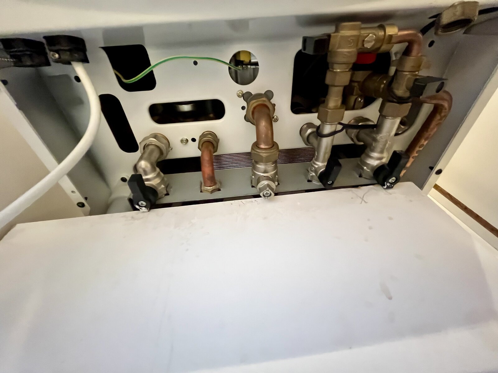

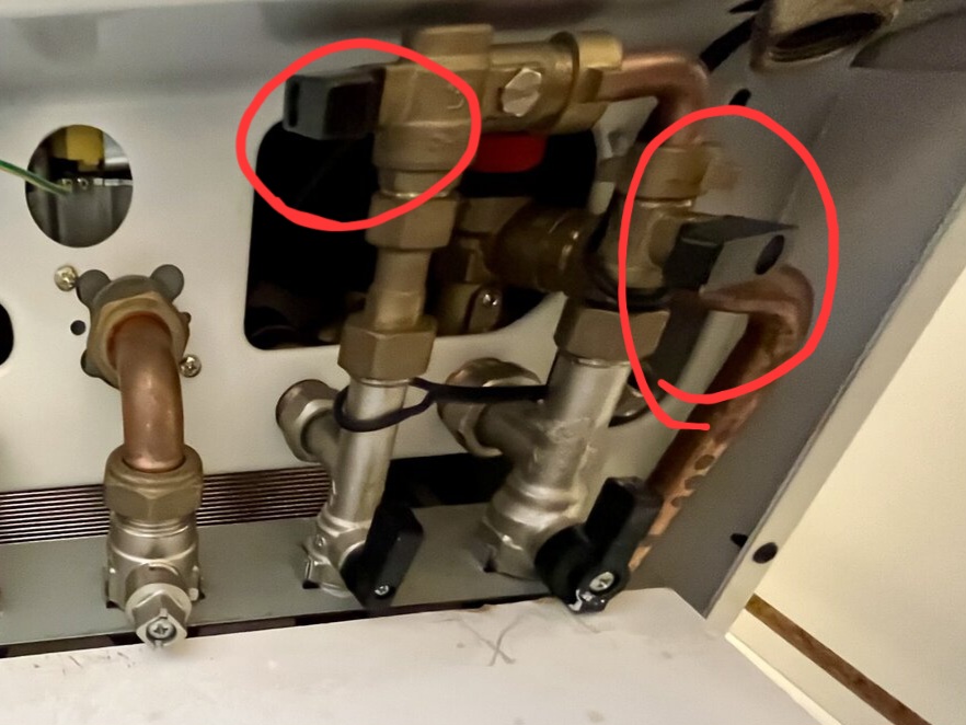

Hello - I've got the Mian Combi 25 Eco Elite and I just can't seem to top up the pressure. I've tried different combinations of the 5 black taps.
Can anyone tell me how to do it ? Pictures attached.
Gently turn this handle 90 degrees, so that it is inline with the pipe...
Leave the other handles as they are.
It doesn't appear that your system needs a huge amount of topping up.
Hello RandomG - tried that slowly opening it all the way but nothing happened at all so I closed it agin. Anything else I could try ?
