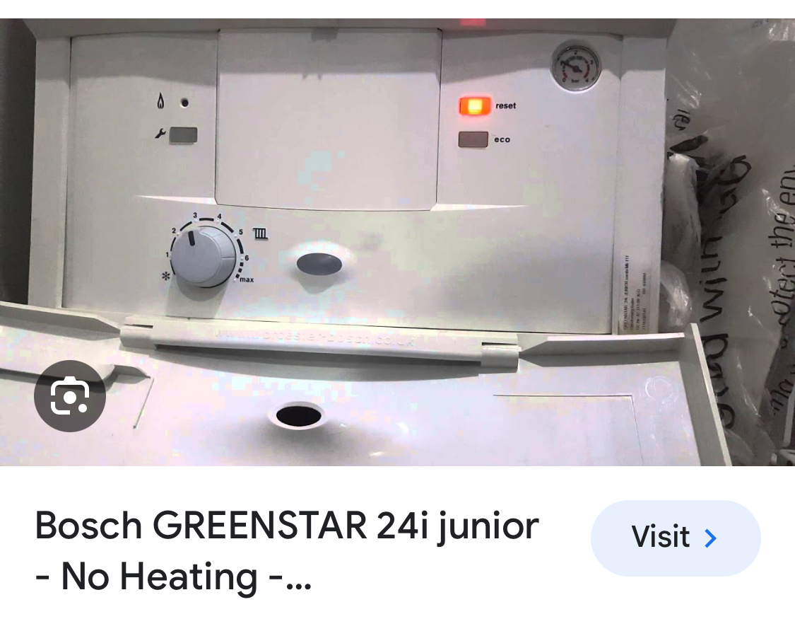

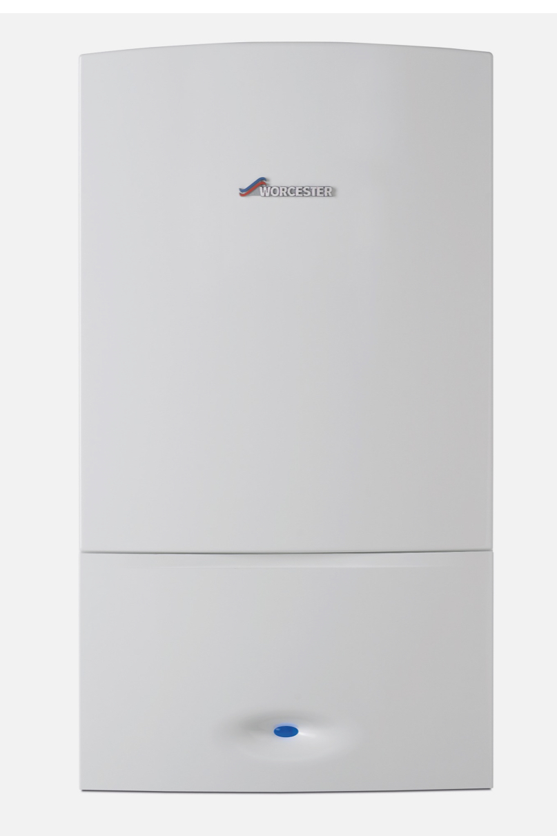

Hi,
Not sure if boiler model as can’t see any labels but look like attached photos.
About 3 months ago is when the issue started.
I could be in the shower & after a few minutes the water in cold. Having to get out covered in soap & press the reset button.
I then started to use the bath but noticed the same issue.
British Gas came out & changed a part & said all fixed.
It’s now done it a few times since & each time I get British Gas out as I have a plan with them.
To me it seems that if you demand more hot water or turn the tap full on the boiler can’t cope so trips if that’s the correct word.
The last visit they changed the heat exchanger & explained why.
To be honest they don’t see to fault find but arrive & just say Oh that’s the heat exchanger etc & replace it.
So it tripped twice Friday, Am using shower & Pm running a bath.
Now today Sunday I’m running the bath just using the hot tap. I felt under the tap & it was cold. Looked at boiler & red reset light flashing again.
I was able to get straight in the bath no problem.
Anybody have any ideas on this as I’m getting fed up now with having to keep reseting it & staying on for British Gas to arrive.
The blue light does flash but not sure if it’s a code as I’m not sure how to read it.

If it’s the same then it’s a Worcester 24i junior. The blue light will either fast flash or slow flash for a number of seconds. Do you know which heat exchanger was replaced?
Not having anything to compare it with I would say slow.
I didn’t watch him change it but when looking up from underneath I would say it’s about 10 inches long and probably flat at the back by the wall.
