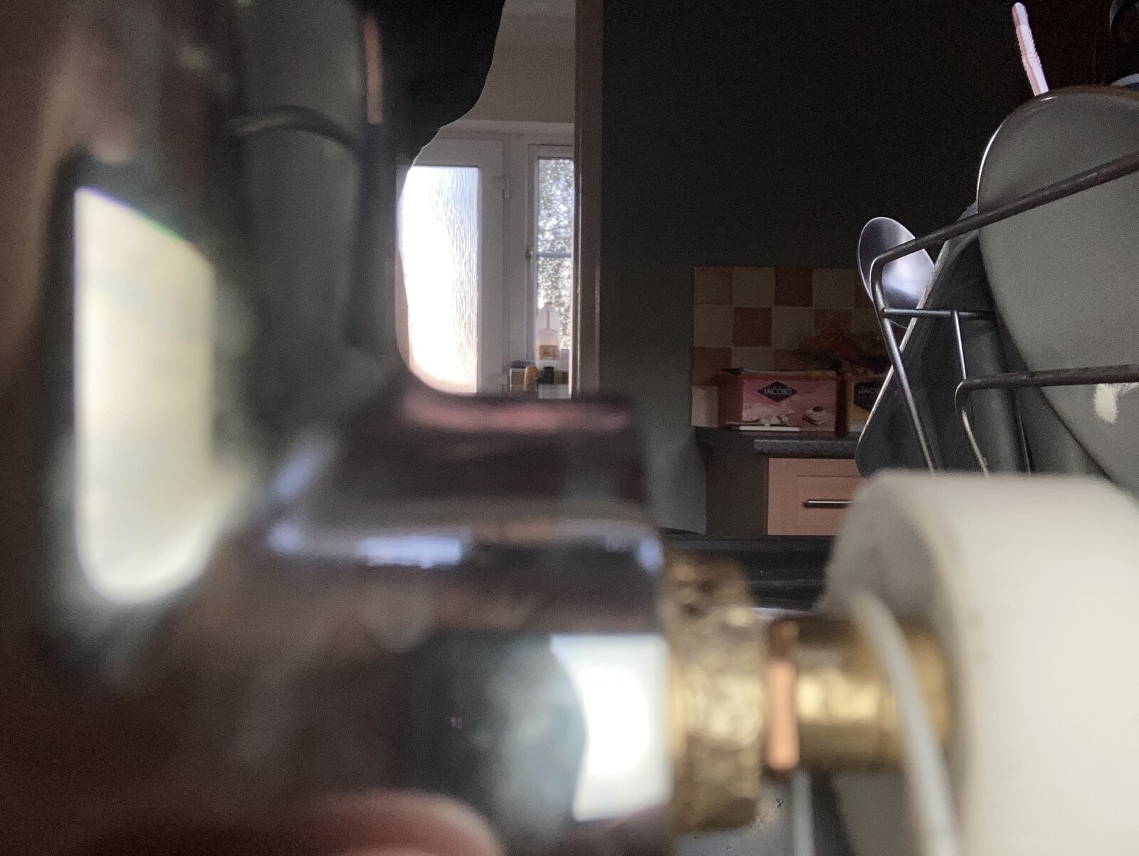

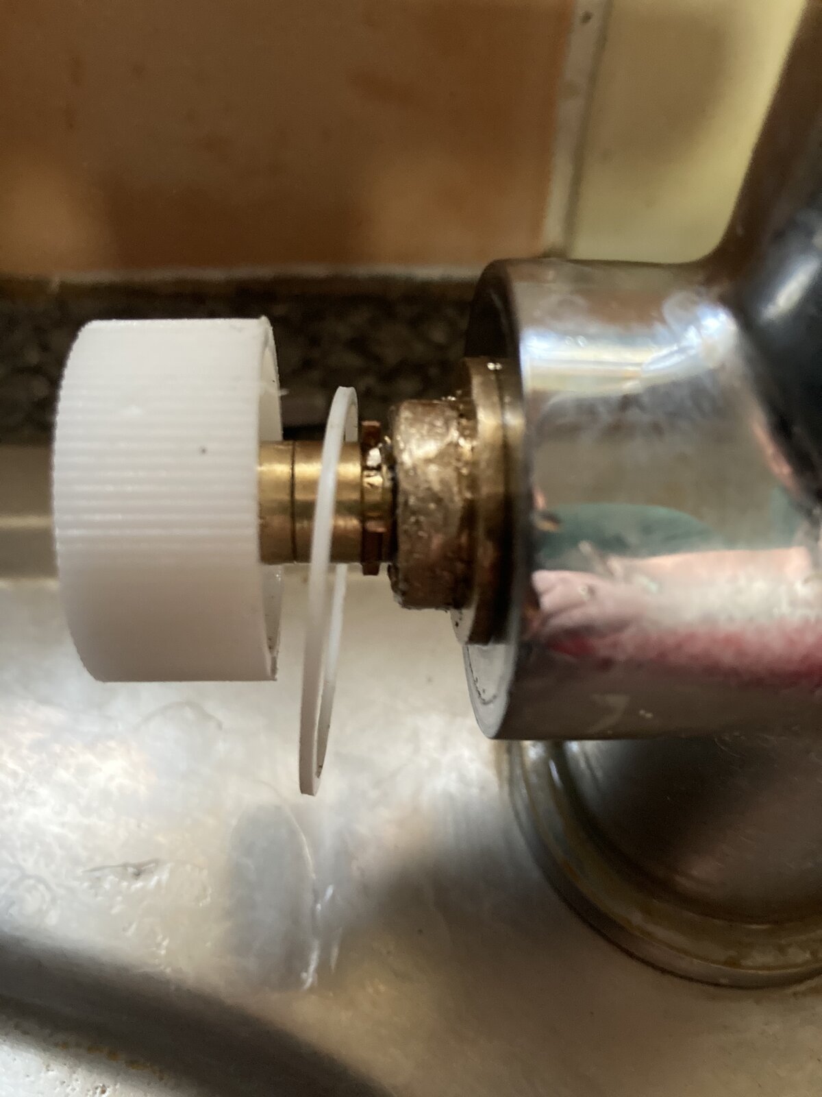

Hi all,
On my mixer tap (hot) there's a nut where you remove the filter, etc - but it's currently impossible to turn, and it looks like the previous owner had similarly struggled as it's edges are quite smooth (so wrenches don't get a firm grip).
What's the best way to deal with this? Are there tricks for getting a decent grip on a nut to remove it and then replacing it with a new one when refitting?
There's lots of suggestions of Google - tried lubrication, muscle won't work if I can't get a solid grip (and even then who knows)... Obviously in the end I could replace the whole tap anyway, but I'd like to try to fix it first.

Sorry - two poor quality photos as promised.
Probably needs a new nut if I get this one off!

1. I don't think you'll find any filters in there. Looks like (it once was) the hexagon nut to remove the cartridge.
2. Stilson wrench would be the best bet, if not, then pipe grips.
3. With either stilsons or grips:
3a. Open end of jaws towards the wall.
3b. Lock on as firmly as you can.
3c. Push handles towards the wall.
3d. Try pouring boiling water over the joint just before loosening. Differential expansion might be enough to break seal.
4. The hexagon is integral with the cartridge, you won't be able to buy the "nut" on its own.
5. Might be less trouble to replace the taps.
