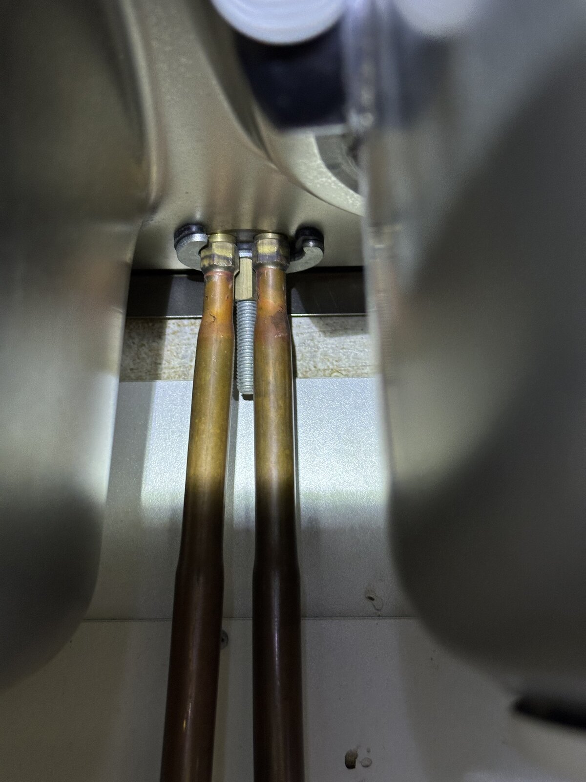

How do I loosen these brass nuts for the hot/cold pipes? I’ve tried all sorts but can’t get a grip of them. Tried using an adjustable spanner but there’s just no space to turn the nut.

You can buy a long specially shaped spanner specifically for that task. Have a look at screwfix or tool station.
Do you mean the threaded nut or the tails.
To remove the tails remove the connection from below the image and then twist them off
Looks like you have to get the tails off anyway to get to the nut

The tails - are you saying twist the copper pipes?
The two copper pipes (hot and cold tails) are connected to another pipe below the image.
Remove that connection and they should twist off anti clockwise. They shouldn't be too tight.
If you are trying to remove the nut at the top of the tails it won't move as integrated into the pipe
It looks to me as though there's solder between the brass and copper; you can see the meniscus.
Much easier once pipes were removed. Thanks everyone for making this a simple job!
