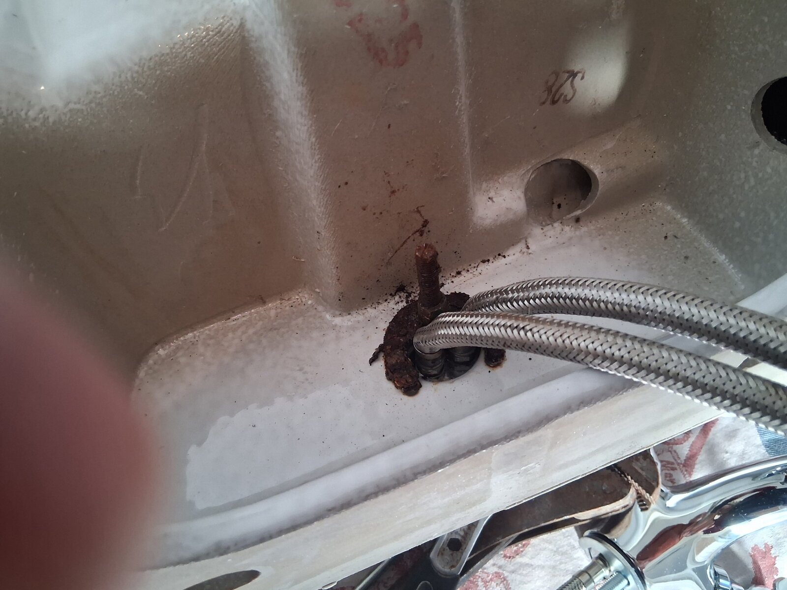

Morning all,
The tap on my bathroom sink has been leaking and dripping for some time, so I've decided I need to replace it.
Having bought the new tap, I thought I would be able to swap old for new with the sink still in place. That didn't work out, as I couldn't find a way to undo the nut that holds the tap in place.
Having taken out the sink and pedestal, I flipped the sink over to find the brass nut covered in rust (see photo attached). It's going to be very difficult to remove the tap from the sink. Fundamentally, I think I have two problems:
1) The nut is very likely to unscrew over the rusty thread
2) Because of the shape of the sink, none of the tools I have (tried footprints and adjustable spanner) can engage with the nut in a way that will enable me to unscrew it.
I think the easiest solution is to leave the nut exactly where it is on the thread and try to unscrew the thead from the bottom of the tap. That means I still need a tool that will properly engage with the nut and give me some leverage.
Can anyone here recommend the right tool?
Thanks in advance
Jever
Soak it in a penetrating lubricant and go and get yourself a box spanner set.
Thank you both, I've sprayed it up with WD40 - that should do the trick, shouldn't it?
Maybe, maybe not.
Small wire brush on the threads helps.
You might be able to rotate the mixer ccw and it will undo off of the threaded rod.
