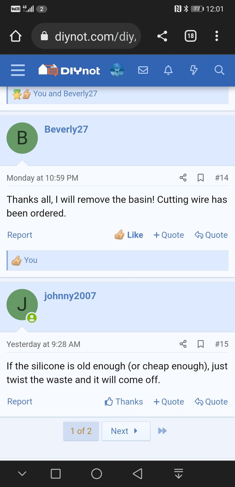

How do I undo this waste nut, which is in a tight spot?

So, we've hit a quite literal sticking point. The sink won't release from the granite countertop and can't be turned clockwise or counterclockwise, even after the use of cutting wire, which we haven't been able to move completely under the sink, because I suspect that there is an inordinate amount of cured silicone sealant there. I'm loathe to use a hammer to try to tap in the Harris filling knife that has a very thin blade and so I don't know what the hell to do next to try to remove this damn sink from the worktop. I've tried spraying WD-40 and pure alcohol on the sealant to little effect. Any other suggestions here please guys? Oh and the new waste is unslotted, if we can ever fit it!
