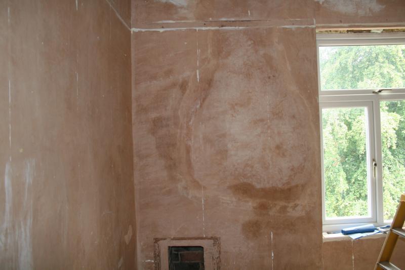

I have a strange damp situation in a first floor bedroom. The damp is over a fireplace and in a sort of S shape. The S loops into the chimney from the floor below. Above the room is a pitched roof.
The room was replastered about six years ago, (just before I bought the place), I have no knowledge about the quality of work other than what I can see. The room still has an open fire place hole, which I intend to close and vent.
The top and bottom of the damp patch, (as measured by a damp meter), are bounded by a pair of courses of engineering bricks on the outside of the building, (the bricks between are original porous Victorian bricks).
On the floor below is the kitchen and I guess that there used to be a coal fire or even a coal range down there but well before my time. I do not know if the chimney is vented on the ground floor as that wall is concealed behind the kitchen cupboards.

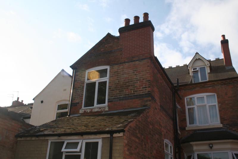

The chimney pots, (for there are three – not sure why), are each capped with a vented cap.
The outside pointing seems, on visual inspection, to be sound and about three years ago, whilst doing other work from scaffolding I had the opportunity to check the chimney stack and the pitched roof which both seemed to be in good order.

The odds are that the kitchen fire opening is bricked up and not vented, and that none of the flues have been swept. No matter what you intend, the flues (all your flues) must be swept, and if, after sweeping, the fire opening's are bricked up then install vents.
All plaster on the c/breast in the pic must be hacked off and then rendered with a 4:1:1 mix of sand lime and cement & skimmed with board finish - do not use any gypsum plaster. Any doubtful plaster on the return wall or the c/breast cheek then do likewise.

Pics of the exterior wall and stack would help?
Okay. Replacing the plaster makes sense. Can you please explain why the rest of that?

Difficult to tell from the picture but they are each capped with a vented cowl

All suspicious plaster comes off now or you might be removing it in a few years time. Flue Sulfuric acid contamination can spread sideways.
