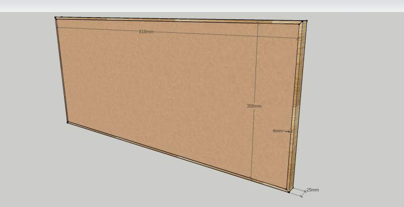

I was warned off creating a composite MDF/pine cabinet door on another thread ... but just wondering if any readers had created this kind of door with success?
Basically a sheet of very solid MDF, edged with 6mm thick oak. The whole thing will be painted, and live in a pretty moisture free environment, so personally I just can't see it's going to be a problem in terms of adverse movement, but thought I'd just put it out there ...
[the reason I want to edge it is to make sure the edges don't bruise/delaminate ... just think it makes the whole thing a lot 'crisper']

That was a completely type of door where you were intending to glue an MDF panel inside a solid wood frame. Veneers and lippings (up to about 8 or 10mm thick - the thinner the better) behave very differently from solid wood frames
Many kitchen and cabinet doors are made by solid wood lipping then veneering the faces of MDF or chipboard. It will therefore work.
Have you considered MR-MDF? It is denser than standard MDF and cuts/profiles with a much crisper edge
I have to agree with the comments about weight. Your door blanks will weigh-in around 18kg or so which may well be too heavy for the screws, especially as the door casing side will be carrying twice that - MDF does not have good screw-holding power so you may need to drill the edges and glue-in hardwood dowels to take the screws

I agree with you about thickness - standard interior door is about 35mm - and I think that 25mm would look a bit "wimpy"

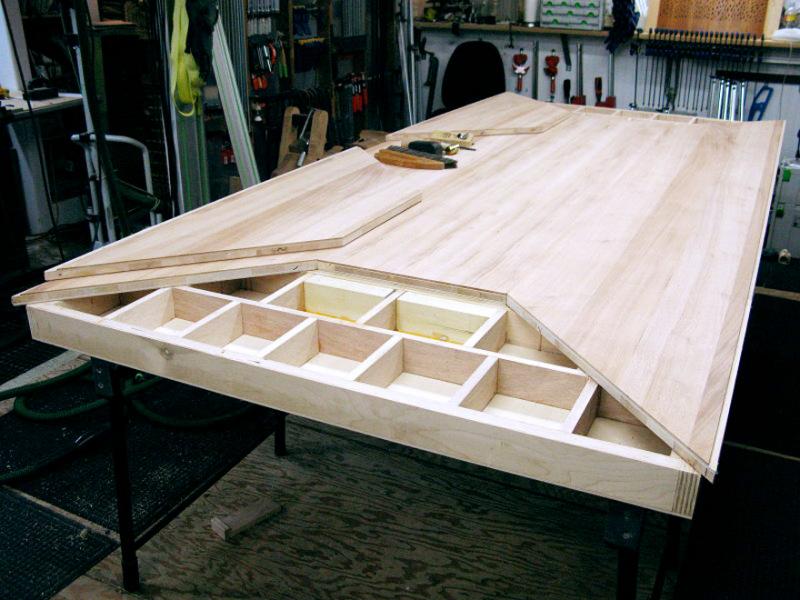

Frame of 2 x 1in planed softwood (finishes at 44 x 22) with additional supports inside the perimeter. Glue to skins of 4mm MDF. If exact thickness is required have the timber yard plane it down to size. If you want something even stronger but lighter then find a hardwood supplier and have then reduce poplar to finished size of 30 x 22mm (poplar is lighter than softwood, but stronger - poplar plywood is used by caravan trade for this reason). This type of construction is referred to as a torsion box

Great stuff ... thanks J&K ... a poplar torsion box it shall be ...
