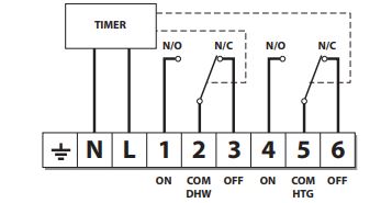

It's a Danfoss FP975, with the door missing.
If you are wanting to replace it with another programmer, the wiring connections are as below:
