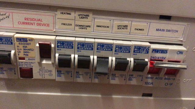

Don't think so. It's on the right hand side of my RCD on the consumer unit which I'm fairly sure is the unprotected side.
Right hand side has: Heating/Freezer, Lights, Immersion, Upstairs Sockets, Shower.
Left hand side has: conservatory wiring, outside garage light, garage, downstairs sockets, kitchen sockets
Ok. but I would have thought the shower would be on the RCD side.

It's an electric shower. How do I figure out which is the RCD side...
I guess it fails current regulations having the upstairs sockets and the shower on the non RCD side. Never really looked at it in detail before till today. Should probably get that sorted one day.
Yes, but probably ok when done - but odd.
Press the test button on the RCD. The circuits that lose their power are the protected ones! Simples!
PS I hate that mix of different maker’s MCBs. I’ll bet the inside is a right horlicks. I suggest having a new CU fitted on your list of things to have done.

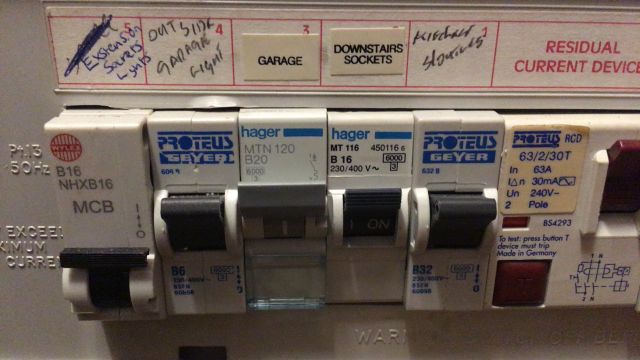

The mix is easy to explain, they were all the same when we moved in but the downstairs sockets occasionally tripped, and the garage always tripped when both the washer and dryer were on together. Turned out they were both 10A MCBs, so got replaced.
The Wylex on the far left was an empty socket and was used for the extension we had a few years ago.
Easy to explain??? Its the sign of a cowboy. Is someone allergic to Proteus or something?
I would be concerned about the history of this. If the original MCBS were 10A it was for a reason. Maybe the cables can only handle 10A. Seen any smoke when the appliances are running? Do you have a fire extinguisher?

The advice at the time was always use Hager to replace Proteus as they're identical but better quality. It's a long time ago but I'm sure I was going to buy the Proteus only to read all the reviews saying buy the Hager instead. Seems like there's been similar advice in the intervening years...
https://www.electriciansforums.co.uk/threads/what-breakers-fit-proteus-boards.28397/
The 10A to the garage socket is literally about two feet of cable from the CU, and is no different to any of the other cables feeding the higher rated circuits. The problem was it just fed a solitary socket in the garage. Must have been good enough for the previous owner, but then we come along and plug both a washer and a dryer using a 2 way adapter, it kept tripping.
Love them or loathe them, consumer units are type tested with their own manufacturer's products in them. Its a bit like you putting after market Chinese brake pads in your Jaguar. How they will laugh as you pile into the chemists shop at the bottom of that steep hill.
Maybe, but what SIZE is the cable? Maybe its only big enough for 10amp! A socket isn't a fixed load, as you have discovered.
