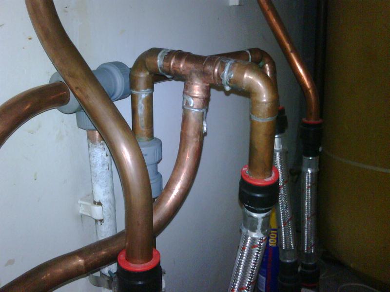

I have attached a picture of the plumbing to the pump. The two pipes from above are the hot and cold gravity feeds. The two pipes heading out of the left side of the picture are to the second bathroom that doesn't work. The two pipes going down in the middle of the picture (one looks white and comes down from the grey T, other has grey join on it) run down to the floor then off to the first bathroom that works okay.
Could the T junction in the middle of the picture be the problem?[/img]
Presumably the pipes to the 1st bathroom run under the floorboards then up to the mixer valve? How are the pipes run to the 2nd bathroom, is it similar; under the floor then up to the mixer or do you have up & over loops down to the shower mixer.
First bathroom - pipes run under floor boards then into Aqualisa shower controller (which sits on the floor under the shower tray). In first bathroom bath, sink and toilet also plumbed into same feed from pump. All work fine - all the time. No up and over loops.

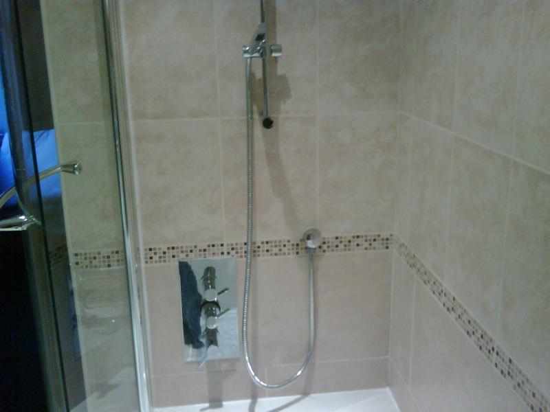

Second bathroom - pipes run under floor boards then straight up and into thermostatic mixer about 1m high. No up and over loops I am aware of here either.
What type of mixer valve do you have in the 2nd bathroom?

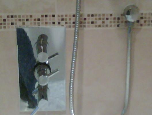

The mixer is an Imperial Thermostatic Bath and Shower Mixer. The pictures attached show the mixer controls. The shower pipe is flexible and attached to the wall outlet shown on the picture (not a fixed pipe right up to the shower head).

Sorry been busy. Nothing obviously untoward in what you’ve said so far but it’s obvious that the pressure switches are not kicking in at the moment on the longer pipe runs; very difficult to say why from here. Didn’t have much luck finding any tech. details about the pump other than it’s now an obsolete model; couldn’t find out much tech. regarding the Imperial mixer/diverter valve either.
Do you have any flow from the bath or shower unit without the pump running? There should still be a minimum flow of at least 1 litre/min or the pump pressure switches may not register & kick the pump in. A 3m head is more than adequate but what are the hot/cold water feeds like, presumably all 22mm; does the h/w cylinder have a separate c/w feed from the storage tank? What is the length of the pipe runs to the 2nd bathroom?
I think your problem may lie in the mixer/diverter valve itself; check for possible restrictions in the valve & does it have a minimum operating pressure?
