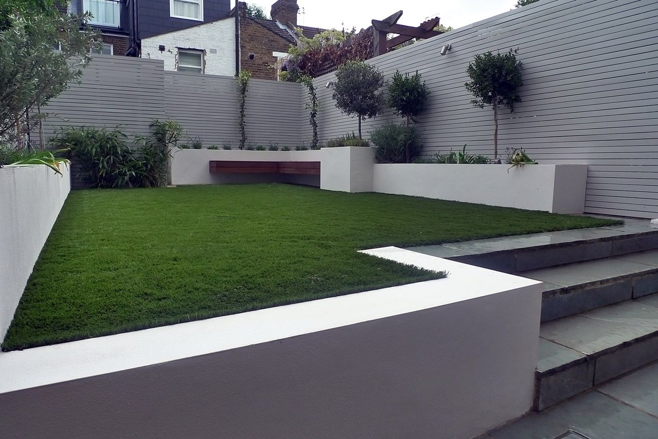

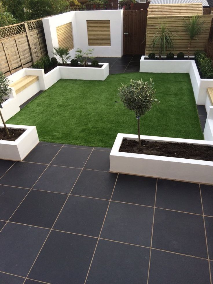

I'm cross posting this because I'm not sure of the best place to post it.
Hi guys
I'm redesigning our garden in lockdown.
Does anyone know if a DIY'er could build these garden walls/planters?
I love the white but also not sure how long they would last until they looked old and miserable.
We do live in the UK after all :)
Any thoughts, ideas, experiences would be a great help.
Thank you
Andy

Probably about a year before they start looking skanky and another year before the render starts cracking.
As Freddie says, but can stall the inevitable by installing a DPM against the inside of the planters before filling and fitting coping stones

I've read a number of posts on here where others have done this and suffered the consequences and that's really sad and disappointing for them.
I'm now wondering if there is another, 'fake' solution??
So something like 'composite' materials where the planters will simply sit on paving and look 'VERY' similar to what I'm looking for.
I also have a brick retaining wall that I was thinking of getting rendered the same as the (originally planned) planters idea, but I guess this would also end up looking a mess.
Damn - I really wanted this look.
