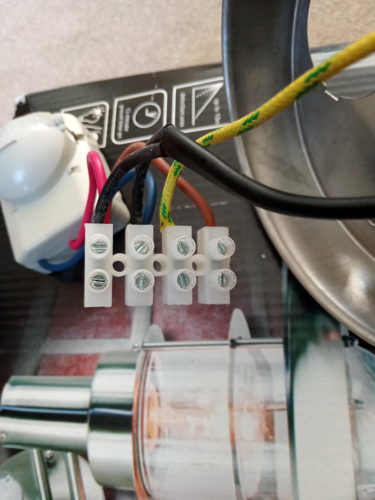

Any chance someone can reassure me on this which is live and neutral,there are no markings.I have red, black and earth going in.

brown live, blue neutral, green earth, the red terminal is the feed to the lamp and unused
