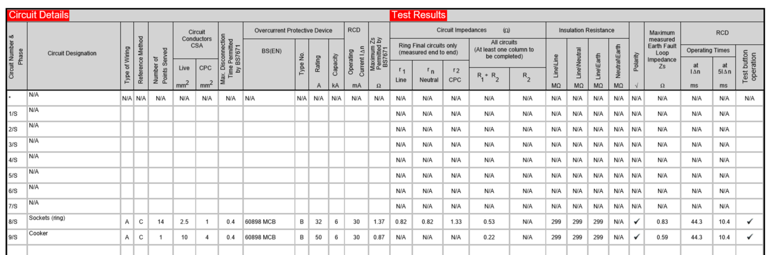

I had an electrician round to fit a cooker circuit a few months ago. Unfortunately he didn't test this circuit.
