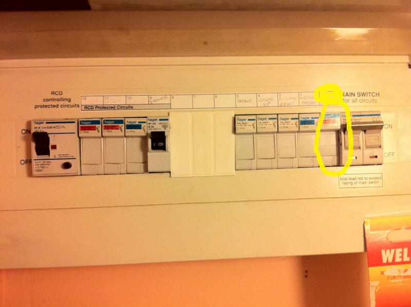

Evening everyone.
Just fitting a kitchen and have finished first fit. As i'm supplying most things and the oven is changing from a single to a double i was looking at the consumer unit today to order a new breaker to suit the uprated load. it currently has a dedicated 6mm cable on a 32amp breaker.
anyway, i'm used to seeing the split load style CUs and no surprise this looks to be one. RCD on left with shower, plugs, etc all labelled. on the right hand next to the main switch are lights, smoke alarms and OVEN! on the far right. oven would have been original fit when the house was built 20 yrs ago.
i haven't opened the CU, i was only looking for model etc, but is it likely that this is right? seems to me that the oven isn't on the RCD unless i'm missing something with the CU design. looks to be a hager unit.
a shower has been retro fitted at some point (its in an extension) and thats on the left side, so unless im missing something this would mean that the original spark and the one who fitted the shower has ignored or done this wrong???
p.s. spark is out on friday but is on holiday - hence the post.
image may help. oven is far right. with the dodgy attempt to highlight it!
Ovens were often put on the Non RCD side of the Board , the only time it was frowned upon was when The Cooker Isolation Switch had an integral Socket on the Faceplate/
Lucky
There's no requirement for an oven per se to have an RCD.
Even under the 17th, if the cable installation does not call for an RCD, and the cooker switch does not incorporate a socket, and TN- earth, no RCD required.
So as long as your oven circuit was compliant when it was installed under the 16th, there is no obligation for it to be brought up to date subsequently.

Sadly, the new cable should be installed to the 17th, which means that if it's buried unprotected <50mm then it should be RCD protected, according to the 17th.
Now assuming that your spark keeps the oven on the non-RCD side (?) and does not bury the cable deep or use earthed steel conduit, then he will not complied.
In that situation, I would take a view that the installation has not suddenly be made dangerous and would still sleep soundly at night. But that's just me.
Indeed. If it would fit (and it looks from the pic that it probably wouldn't) upgrading the MCB (which has to be changed, anyway) to an RCBO would be one solution - or, as you imply, the electrician might decide to try to wire the cooker circuit to the RCD side of the CU. As a final option (if an RCBO wouldn't fit), the electrician might leave the cooker circuit where it is in the CU and give it an external RCD (in an enclosure) of its own.
