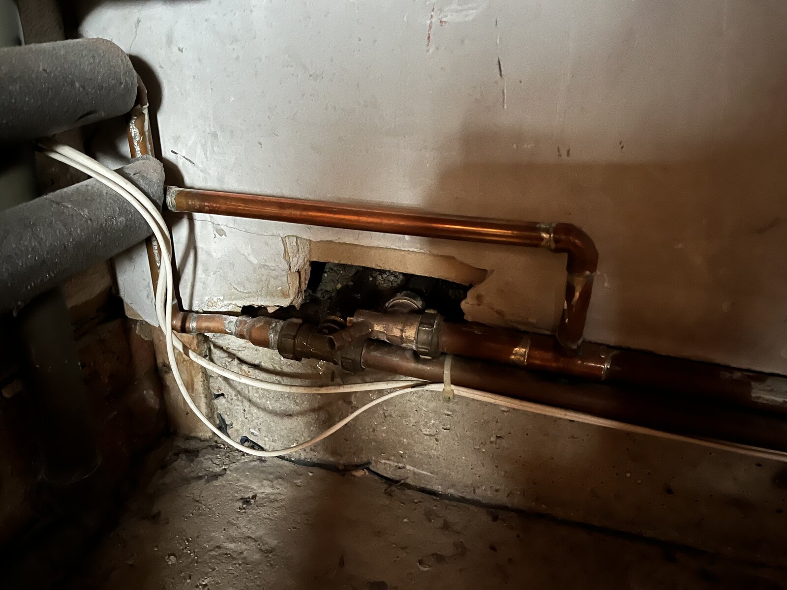

AGAIN DID YOU CLOSE THE BY-PASS MISTAKENLY WHEN DRAINING

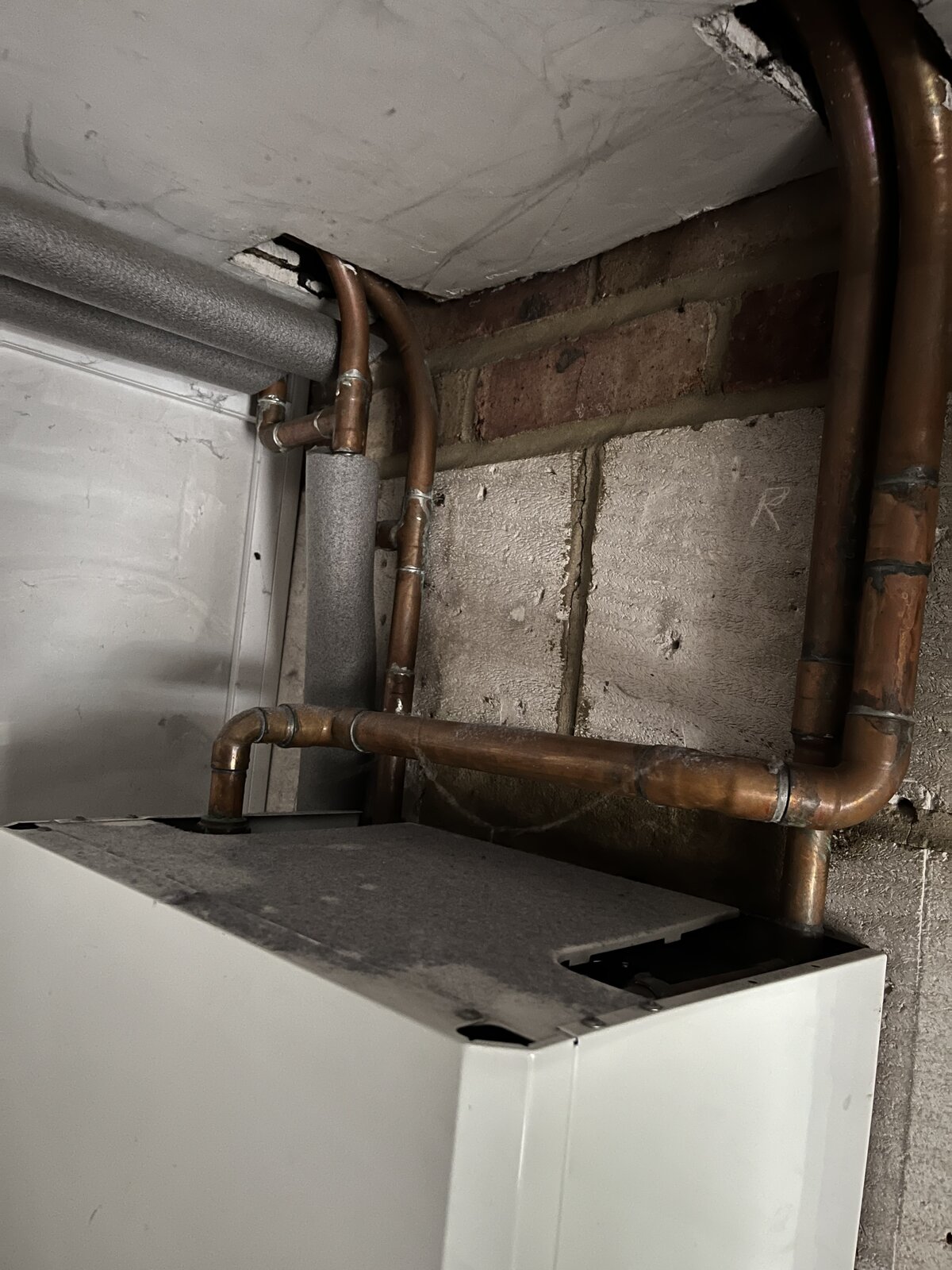

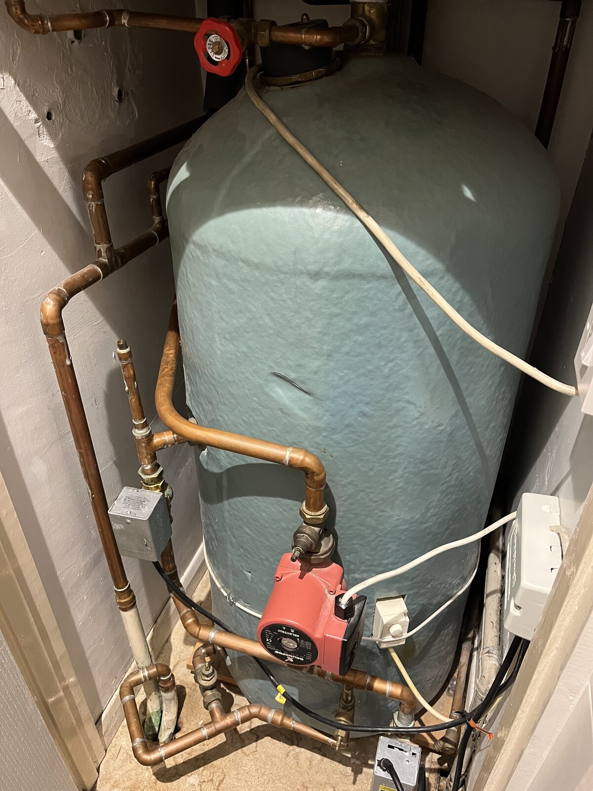

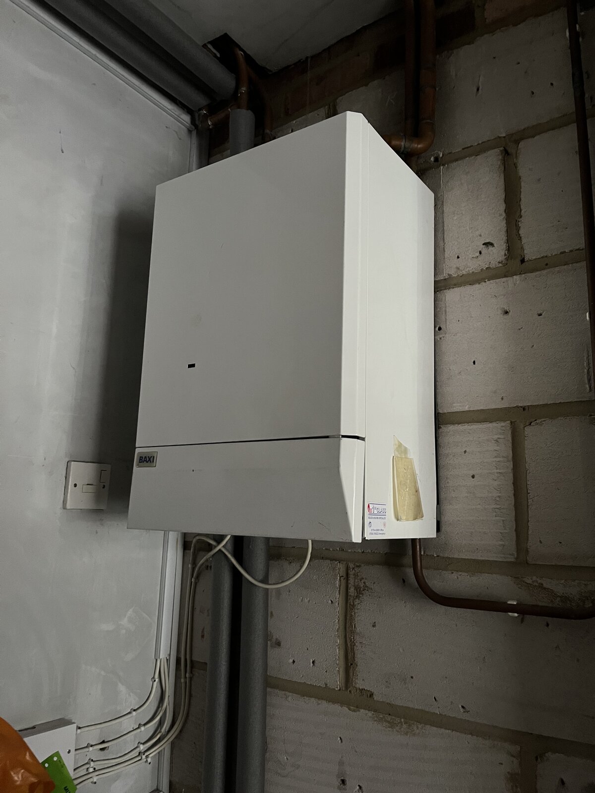

Sorry overlooked your message. I’ve looked, but I can’t see anything that I could have mistakenly turned off. Some photos attached.
Where I drained off:
OK on your final pic, below the pump and slightly to the right that gate valve is your by-pass valve, with the boiler hot turn off both CH & HW and feeel that pipe is it staying hot ? it should that is how the pump over run facility dissipated the residual heat from the boiler when both zone valves close

I’ve just felt that pipe after switching off CH and its cold. Pump runs for 3 mins after shutting down CH and I can hear the valve close, so where the hell is the water going? To me it felt like water still going through the CH, but it’s obviously hot and the vibration might just be the motor.
I’ve never touched either of those valves, how do they open? Surely if it’s open it should stay open.
Thankyou, might be getting somewhere.
well it should be hot, you turn the valve anti-clockwise to open, use a small adjustable spanner and turn it clockwise all the way in then turn it , back out again, they sometimes snap inside and need replaced, you eill know as you do it if it feels like it is actually closing and opening
I was able to give it a turn, and the pipe became hot. There was definitely nothing running through it before then.
How it became closed after changing some radiators is a mystery, there's no way I've forgotten putting an adjustable spanner to that. Hopefully, that's sorted the issue; thanks again.
yes that is definately your issue
