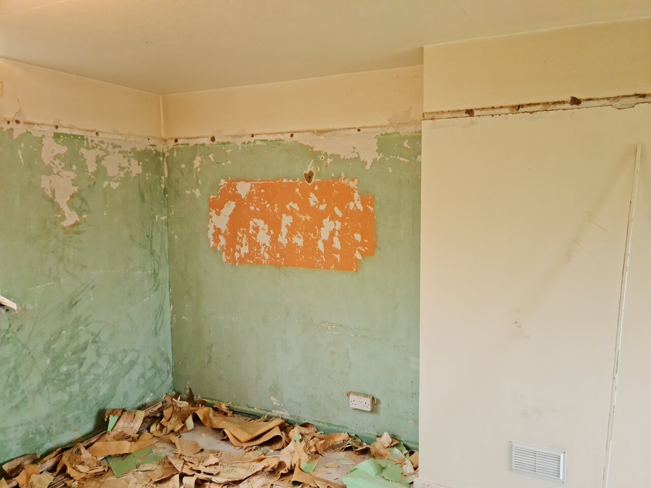

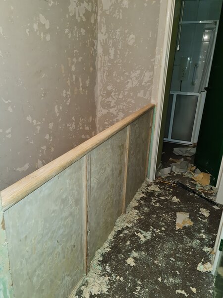

Hi all,
Just moving into a new home (for us) and the walls were layered in a lovely floral green from the 1960's. I've managed to get all the paper off, however underneat, is an absolute mess.
A mix of patchy paint work flaking off and bare plaster. What is the best way to bring this up so that I can paint nice fresh white walls for the wife before she bury's me?
I had planned on sanding the walls as much as possible to take any flaky edges off, then give the walls a mist coat, followed by a couple of decent coats but am worried that the paint below will create a noticeable uneven surface.
Excuse the mess! It's a work in progress and not lived in yet, but will be very shortly.
Skimming isn't an option unfortunately - time restraints and most plasterers are fully booked for the next 3 months :-(
Get as much loose stuff off as possible, use a fine surface filler in the worst bits, then use a thick lining paper. Once painted it will look fine. You won't totally get rid of the underlying texture of the slight craters caused by the missing paint areas below, but it will be perfectly acceptable. Do use a matt paint and not a silk as this will also help to flatten the look of a flaky wall.
Ultimately the only perfect way is to re-skim.
By the time that you sand that flat, The Mud slingers will be available.
Looks identical to my first house.....Unibond and skim is the way !!
Use a wallpaper steam stripper, or paint stripper like Nitromors ( nasty stuff ) it's obviously got a coat of distemper under those layers which you'll have to wash off when you get down to the base. It's a pig of a job. Wear googles when you wash it off as it's got lime in it, then use either an alkaline resisting paint or at a push a paint stabiliser before you repaint or for quickness just stick plasterboard on and either get it skimmed or tape and feather the edges out and paint directly making sure you water the first coat down, read the instructions on the paint tin, not many do. otherwise it will just form a skin if you paint a porous surface straight from the tin.

Unibond won't neutralise distemper, the plaster skim would flake off over time and silk emulsion skids on Unibond.

Just done almost exactly that, although, no lining paper. However got the walls free of all paper and paint first. Was lucky. 100yr old walls had been, what I could tell, painted once, and papered subsequently.
At one stage tile adhesive was used to put up highly flammable polystyrene lined wallpaper. That was fun to remove.
Scrape, wash,fill,sand,stabiliser,paint,fill,sand,paint. Used Farrow and Ball estate emulsion very matt.
Looks great. Managed a 21x12x8.5ft room over a few weeks of evenings. Washing and scraping paste, paint and distemper was messy.
Worth it.
Can't even see where the picture rail was.
