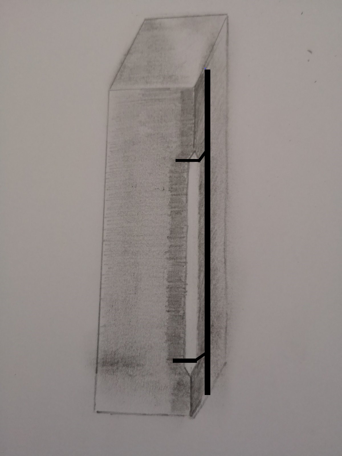

I'm doing up a dump with woodchip paper everywhere. The Hall is my next forage into lining and I have now stripped two square pillars with two corners squared off and tapering to a point , like an arrow. These two pillars support an arch which seems fairly straightforward - but the pillars are not! I have made good any imperfections and done half and half unibond and water to help the lining paper adhere. How can I line these two pillars without making a botch of the squared off corners and their tapered ends? I looked at the way the original wood chip was done, but the woodchip hides a multitude of sins!

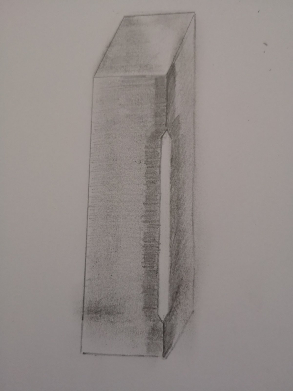

Thank you Opps for that - very useful. Here is a rough drawing of my quandary. I over paper from one side and over paper from the other side, then cut with a very sharp cutter...is that correct? Thanks, Peter

The only suggestion that I have seen posted is that the paper should be set up to go all the way around the corner, so that it is sitting square on the top and bottom arris (therefore loose over the bullnose section). Then, using a blade, slice down the middle from arris point to arris point over the bullnose. The rest of the post however less clear but apparently involves overlapping the cut edges over the bullnose section.

I would cut it like this
pillar.101593
You will end up with two tiny triangles that have no lining paper on them but once painted, it shouldn't be obvious.
Wrap and do the horizontal slices on the first piece of paper around the corner and then before it starts to dry, lay the second piece over the top and cut through where the vertical line is. Remove both excess offcuts and apply a bit more paste to the edge of the second sheet.
Erm, hope that makes sense.

Thank you Opps for this latest answer - sounds perfect! I may try it out first on a dummy run, then apply myself! You, sir, are a pearl!
